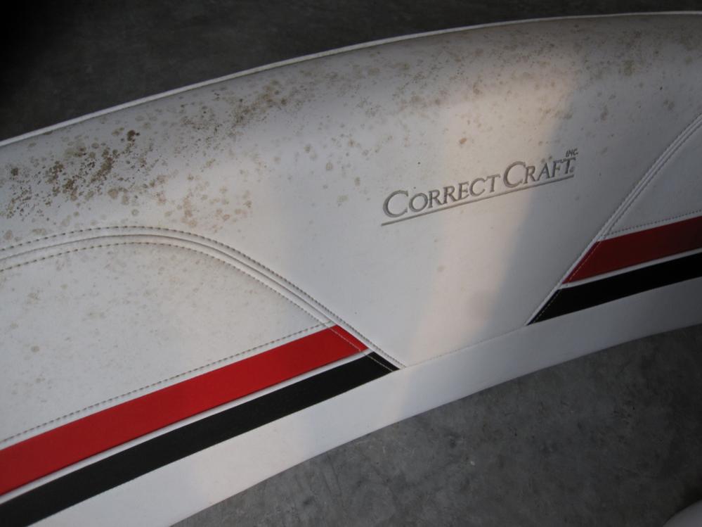

Originally from the very dry climate of Lake Havasu, Arizona, we've just learned a hard lesson about Florida's climate. We just went to get our boat out of storage yesterday, which was a rack style indoor storage facility at our local marina. It seems the boat cover must have gotten wet sometime during the winter season. Needless to say our white upholstery now looks like leopard skin seat covers and the boat smells like mildew. Short of buying a new interior, does anyone have any suggestions for cleaning this mess?

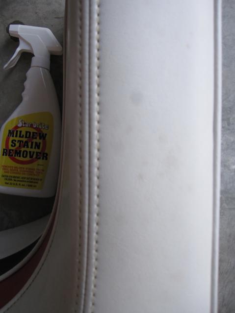

I tried the Star Brite Mildew & Stain Remover. It did get some of the stains off, but there is still a ghost of the stains that is about 15% as dark as the original. Some have said it will take several treatments. In any case, this is going to be a project. Thanks for your comments and suggestions.
You can see from the new photo the problem is much better, but the stains still can be seen.
