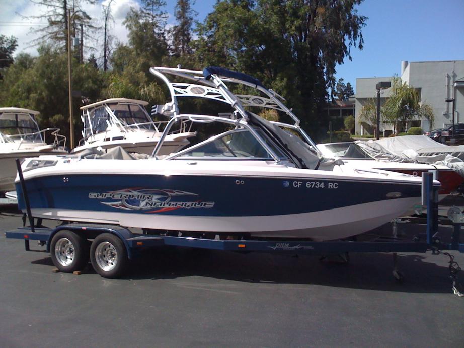

    I am upgrading the old decals that are faded and torn to the new Griffin decals. Has anyone tried removing the metallic tribal swirl decal? I heard maybe a hairdryer and plastic putty knife would work?
    Do the right thing.......
  • G-man
    • Jun 2004
    • 428
    • Allen, Texas
    use the hairdryer without the use of the plastic putty knife on a warm day. 3M makes a spray glue remover solution that works well also. Take your time and you'll do fine.

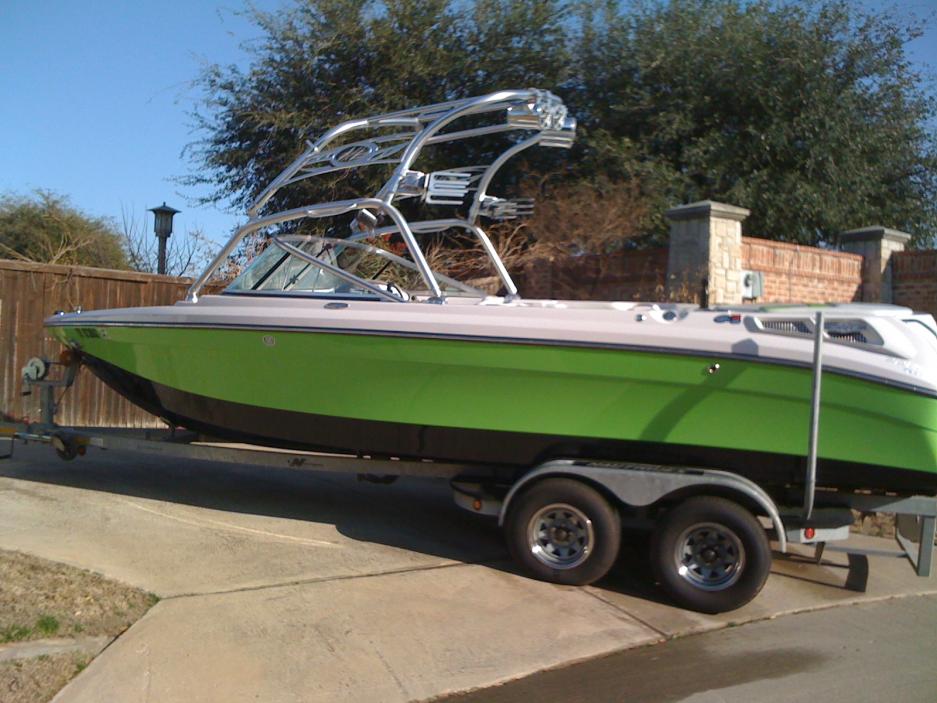

                        I finished mine yesterday. It turned out great aside from a few bubbles (that hopefully dry out) and two wrinkles. For anyone who doesn't know, the graphics are sandwiched between two layers of film. The bottom layer is like on all stickers and protects the sticky adhesive on the graphic. The top layer holds the graphic together once the other layer is peeled and protects the graphic from your squeegee and also makes the graphic more rigid during application. The biggest recommendation I have is to leave the top layer of backing on for a day at least (in warm weather) until you know you have a complete bond from the graphic to the paint. A few days or even a week wouldn’t hurt. It’s tempting to take it off to see what the finished product will look like. Removing that after only a few hours on one decal is what caused one of my wrinkles. After I saw that I decided to wait a little longer before removing the rest. The wrinkle is not longer than my finger is but I'm pissed at myself for loosing patience. Also, my dealer said not to put the boat in the water for a couple weeks after decals. The process isn’t rocket science but it does require planning and patience. If I could do it again I could do it wrinkle free. I think a few bubbles are unavoidable even by the pros. I used a 32oz bottle of water with 4 drops of regular dishsoap. If anyone wants me to do theirs in Dallas I would for a fee. Good luck and if you have questions let me know.
                        Before:
                        After:
                        2006 SANTE 220
