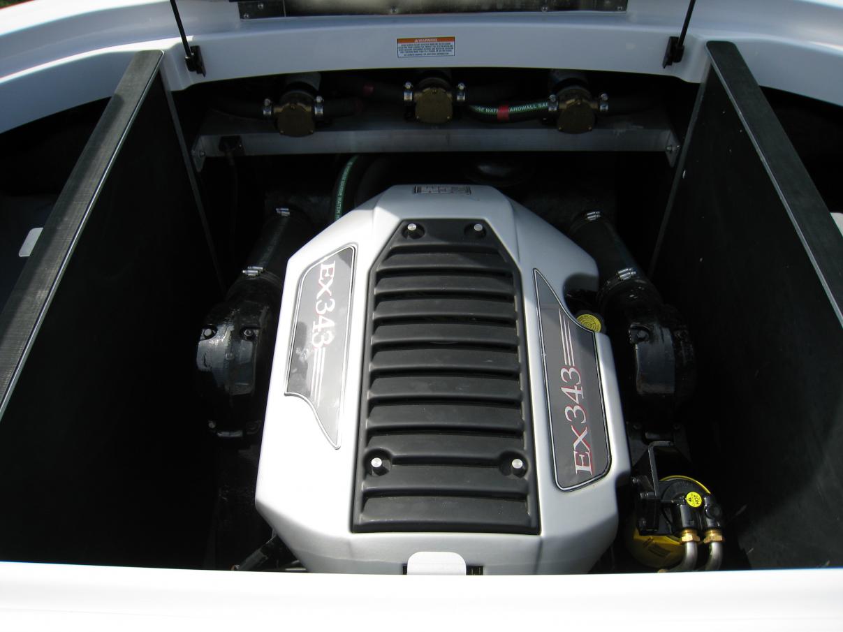

      I have an 08 210TE and we have the fire system. I don't have any pictures of the fire system specifically but looking at the motor picture here, the fire bottle is located in the upper far left corner under the exhaust manifold. It's so hard to see the when we first got the boat i thought they had forgot to put it in. It looks just like a normal fire bottle with a sprinkler type spray head on it.

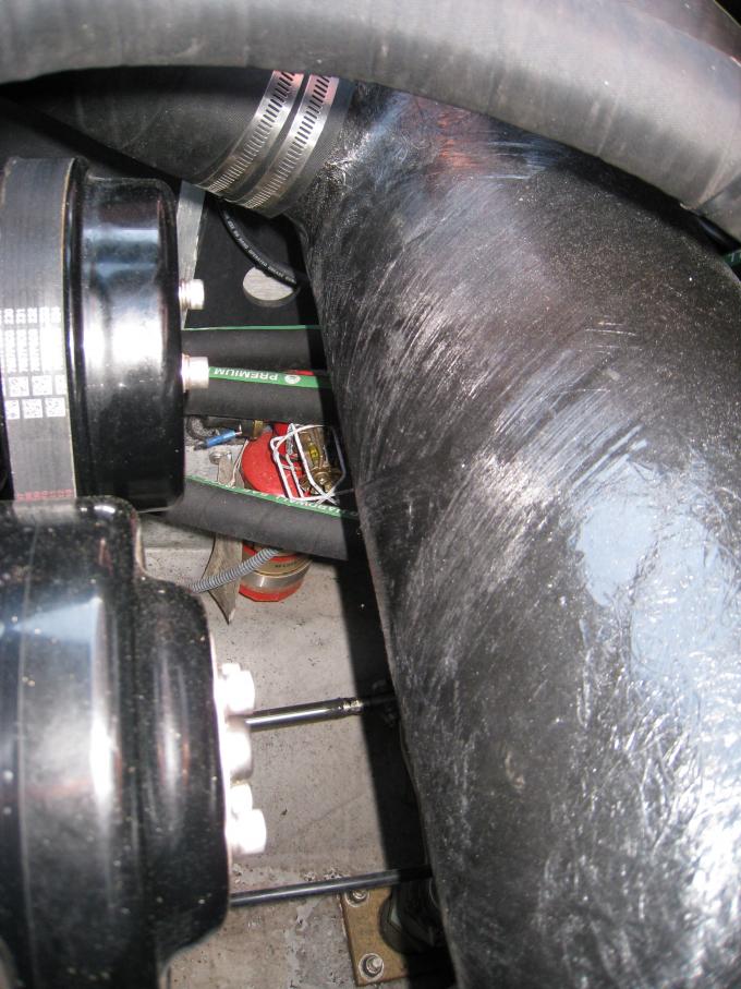

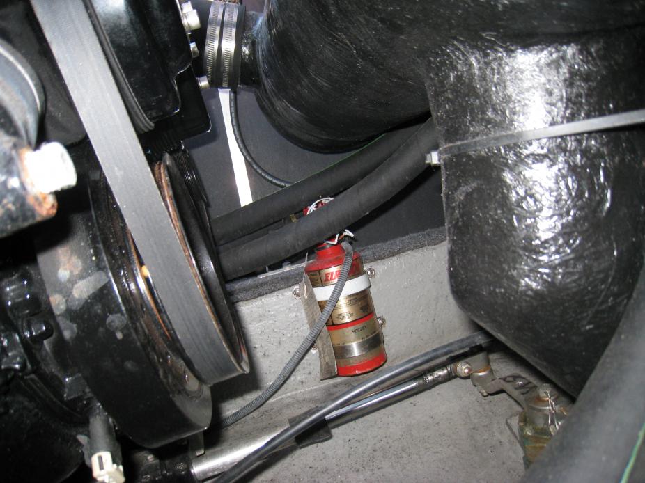

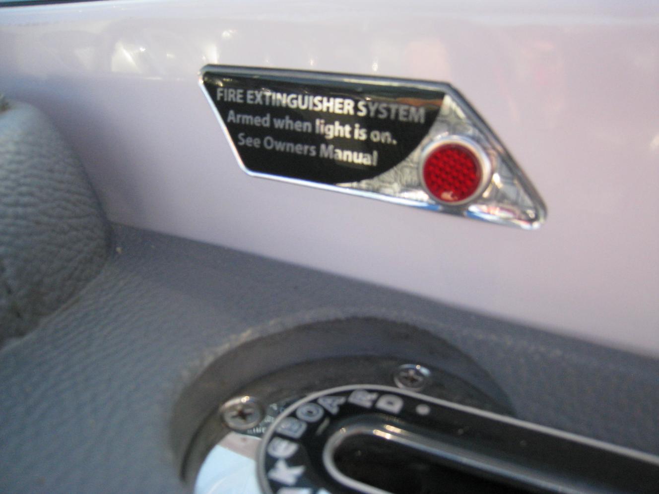

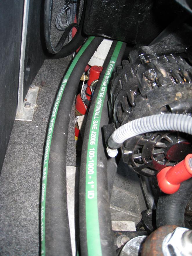

        I was able to get some pics of the fire bottle for you.
        2012 SANTE 210 (it's official)
        2008 SANTE 210
