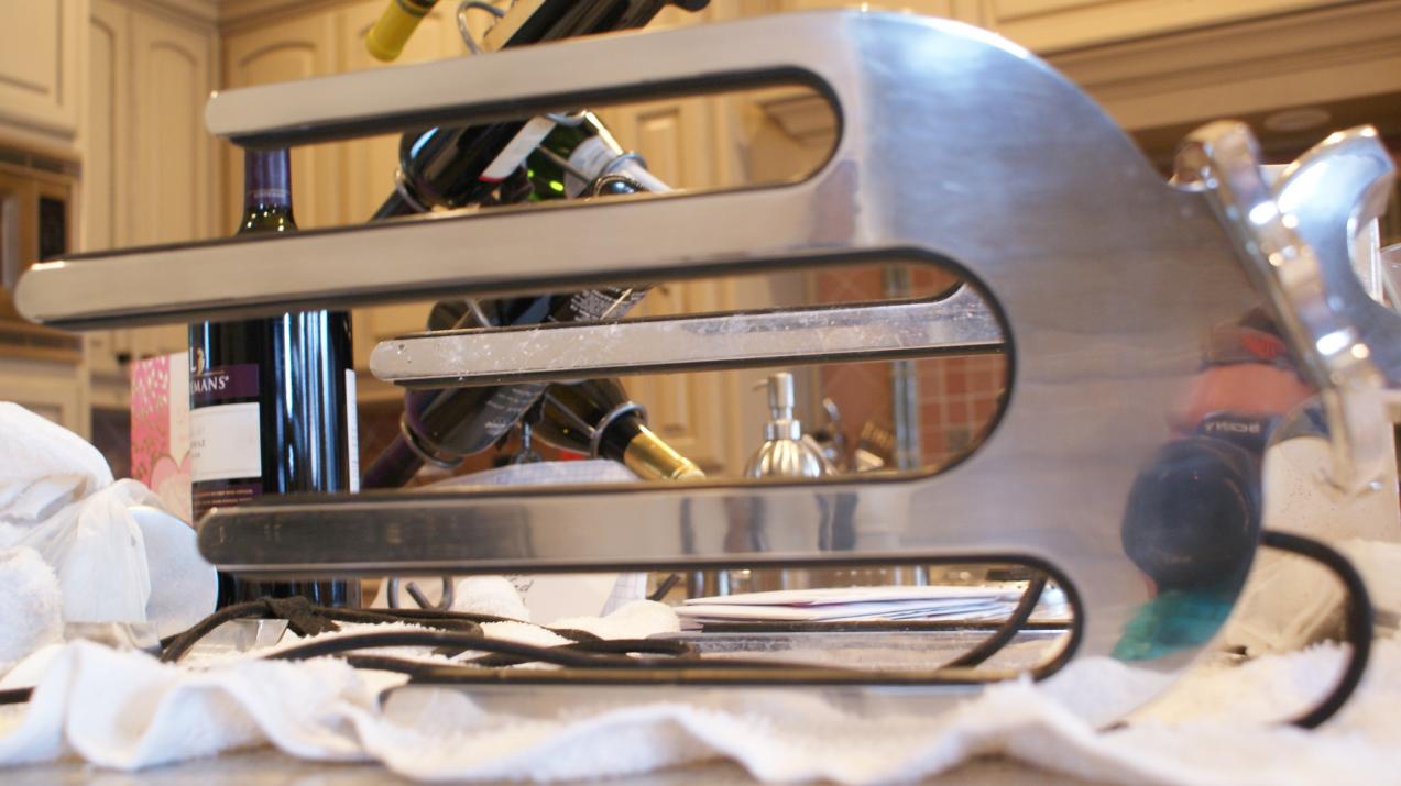

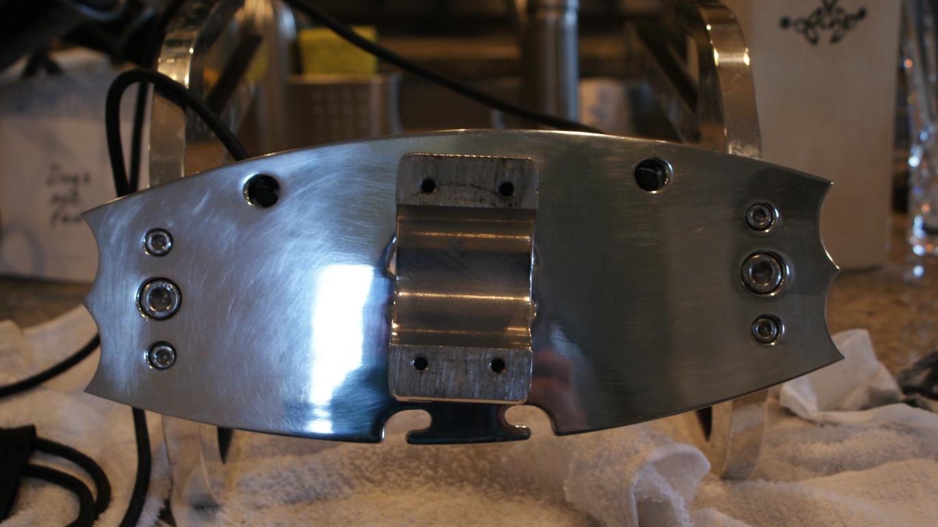

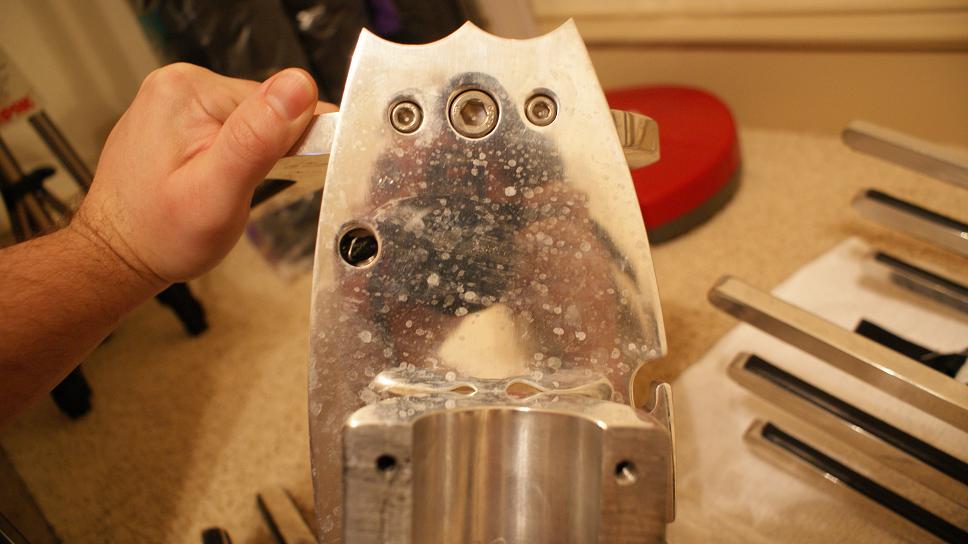

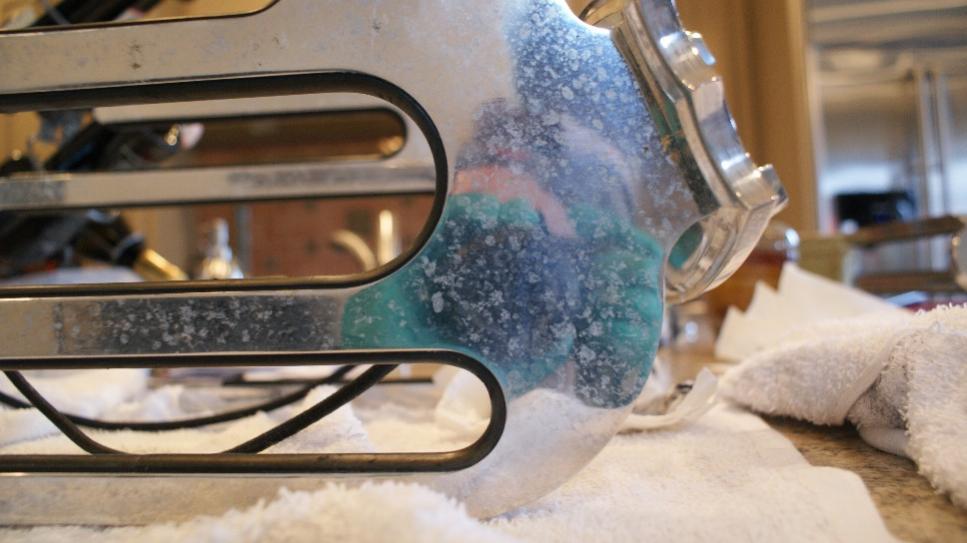

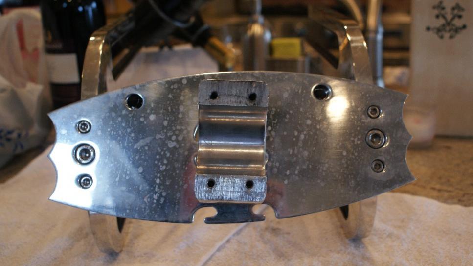

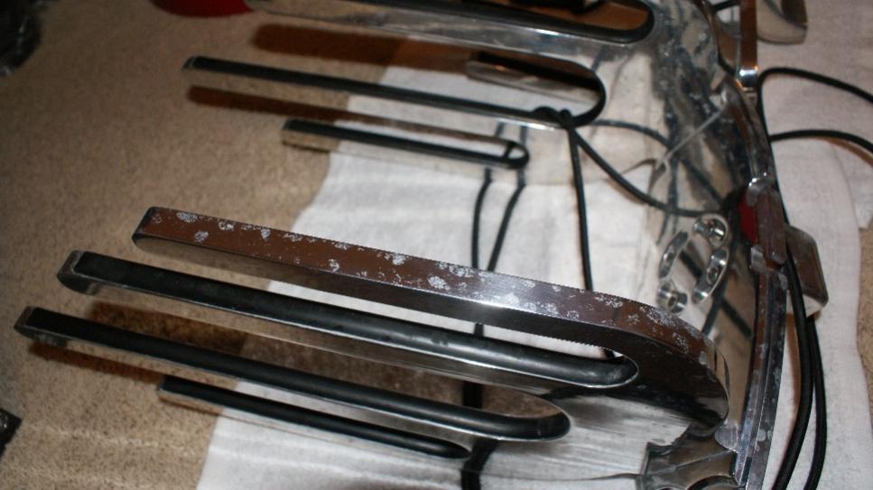

For anyone who cares, I tried the Eagle One, which worked better than the Mothers mag and aluminum metal polish, but still left a some of the spots (although pretty hard to see unless up close). On a hunch, I thought I might try some Barkeeper's Friend (after just using some with typical great results on my 12" stainless All Clad fry pan). It took the spots out pretty well, but left a somewhat dull finish. I followed it up with the Mother's polish and am satisfied with the results. Here are some before and after shots.Now
2000 SAN
Previously
1999 Air Nautique
1996 Tige Pre-2000
