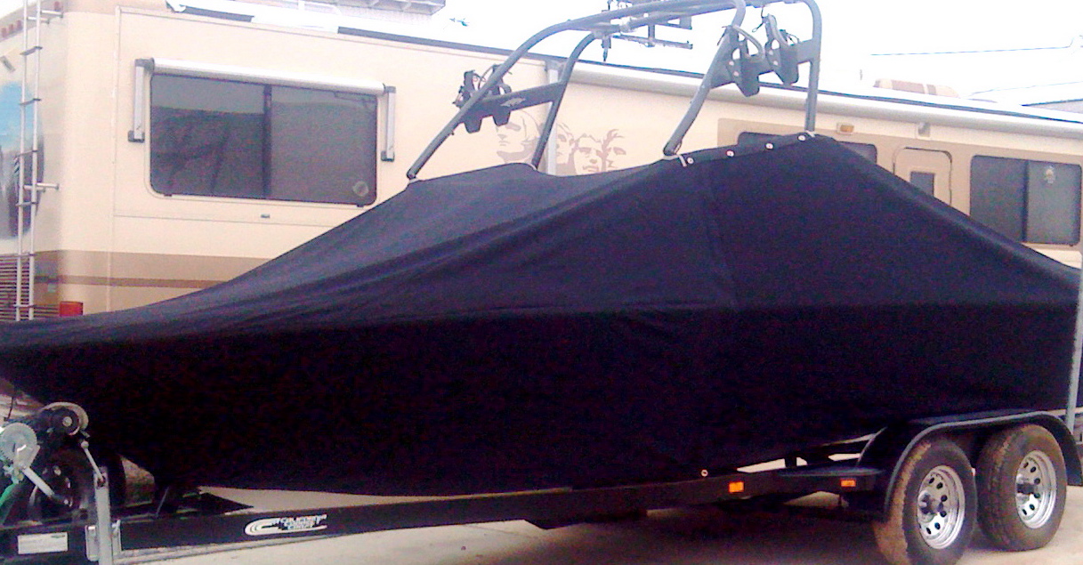

Sorry to hear your bad news. No matter what the problem is, it sucks when you have to throw 'extra' money at your boat. Even with routine maintnance stuff goes wrong thou. On a side note: Where did you get your boat cover? I think it looks great and I would like to find out about getting one for my 210.

Thanks for the feed back. I have had the boat serviced every year and the trans oil was changed about 150 hrs ago. The wire was cut that went to the warning light so no light came on when the v-drive was hot. sounds like the boat is going into shop for work. so sad but a lesson learned. I have all ways tried to take good care of her but things can go over looked. The Boat Cover was custom made for the boat it self. sunbrella 1,500.00 I have one that is 6 years old and it looks new. so cal area is the guy that did it let me know if I can help you get one.
