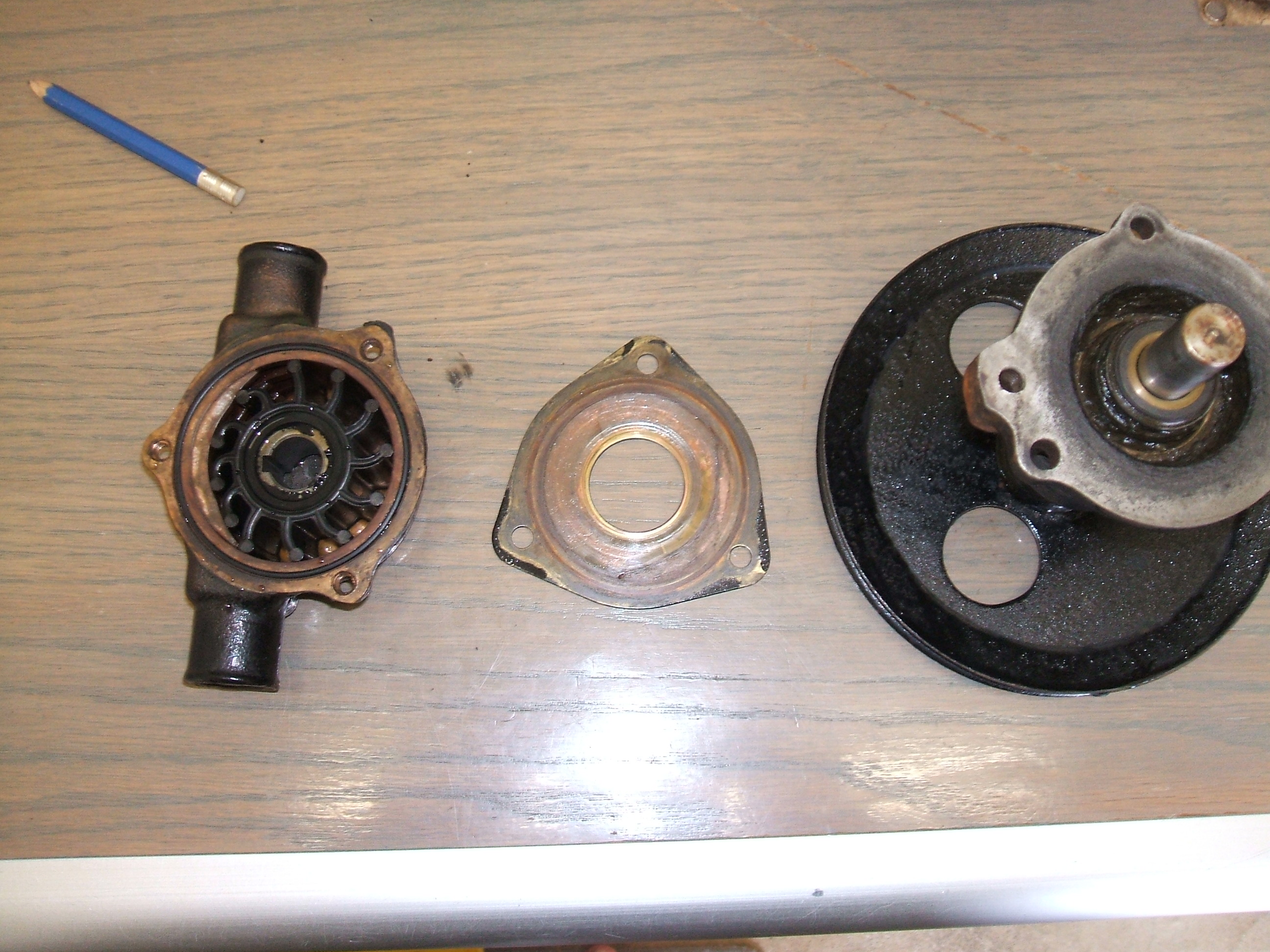

I recently replaced the impeller, o-ring and gasket on the raw water pump on my 98 Ski with GT-40. I ran the boat on the trailer to test for leaks and noticed that the pump has a small drip leak. It did this before I changed the impeller, but on a previous impeller change I didn't have the proper gasket and made my own, so I thought it was from my home made gasket. This time I assumed since I had all the correct parts that the leak would be gone, but it has not. On closer inspection, I can see that it doesn't appear to be the gasket at all, as it's coming out of the pump shaft.

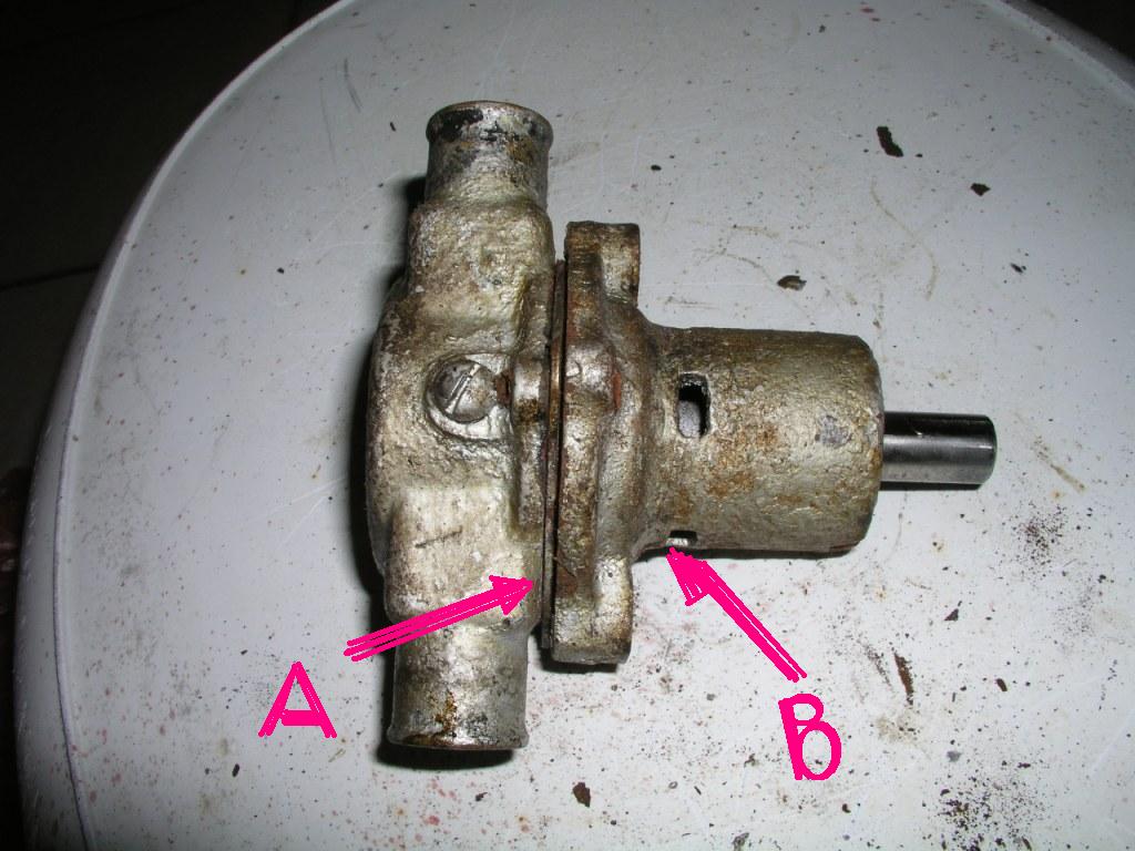

I borrowed a pic from another post to show exactly where the water is coming from, it is marked as "B".

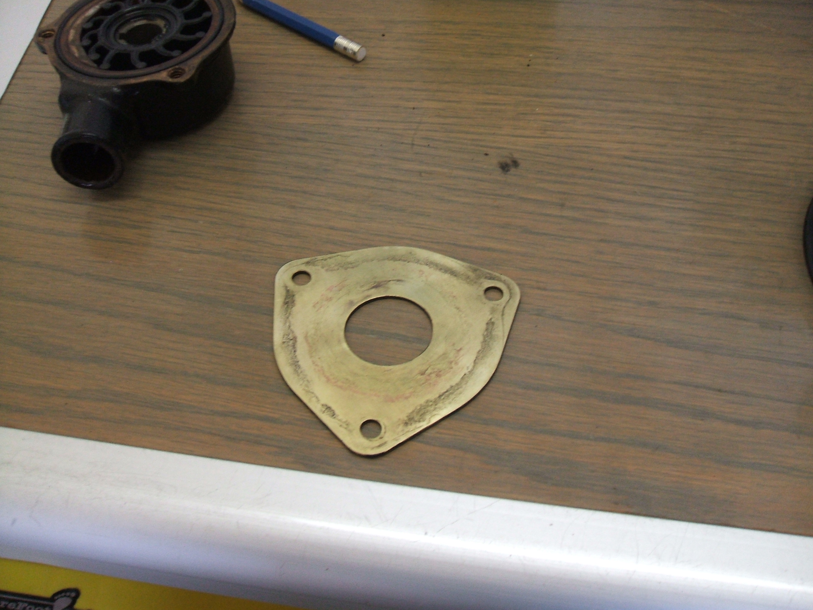

I pulled the pump apart twice to be sure that the o-ring hadn't slipped out of the groove or there was any old gasket there, all checked out OK. Since water is coming out of the pump shaft, seems to me that water is leaking out between the impeller and the spacer plate, then out the holes in the pump shaft.
While the leak is only a drip , is this an indication that I should replace the spacer plate or the pump itself? As best I can tell the impeller itself makes the seal so water doesn't escape through the hole in the spacer plate into the shaft side of the pump.
Would appreciate any suggestions or similar experiences.
