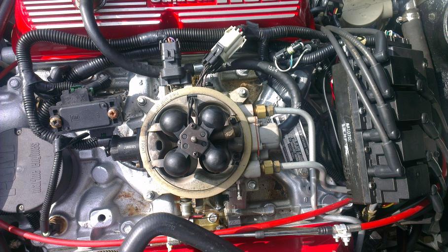

          Here is how it looks like.:
          I think this is throttle body injection system and its is Pro Boss and not a GT40 right..?
          BTW I need a service manual for this engine. Do you have any link .?
          Thanks

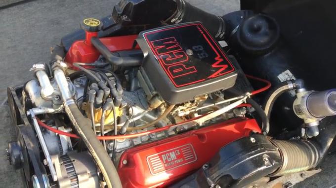

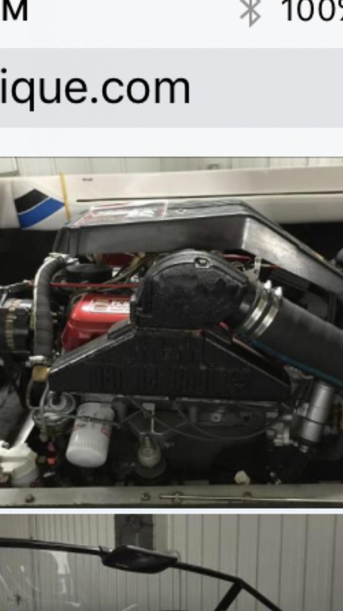

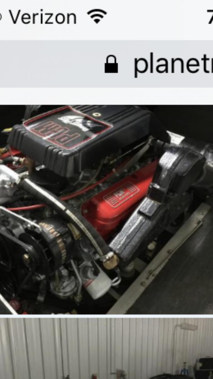

                  Ok so for 1993 PCM had the Ford 351 WITH GT40 heads @ 280hp and WITHOUT GT40 heads @ 240hp? Did the plastic engine cover and sticker indicate this head difference then? Was that why I'm seeing the small square plastic cover and the larger engine cover? Looks like from
                  below pics the regular non HO 5.8 had the smaller square engine cover with regular distributor type ignition while the HO 5.8 had the protec electronic ignition with larger engine cover? Does this seem correct to assume?

                    No. The larger shroud came over the protec ignition which was common on both standard and HO offerings.
                    Heads were the primary difference between them. The engine tag should tell you which you have, or the markings on the heads themselves.

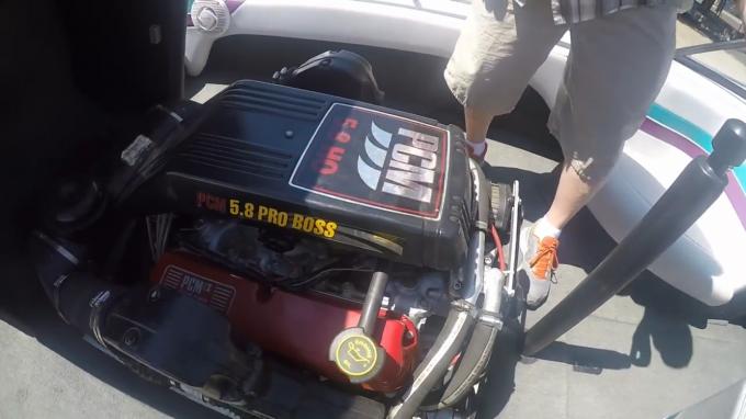

                          I have that engine
