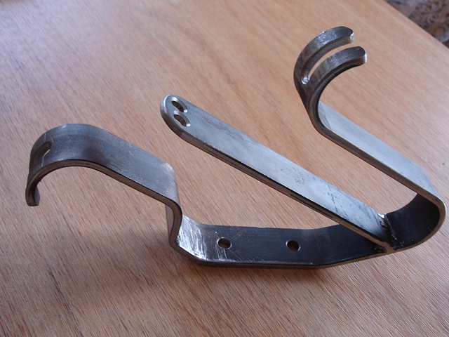

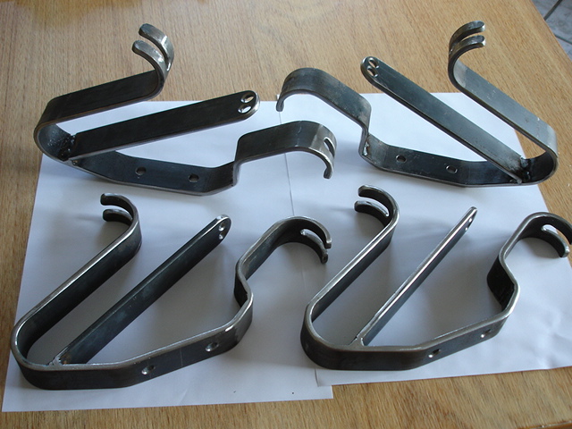

            Hi these clips are so expensive here in Germany I decided to make them myself.
            Andy
