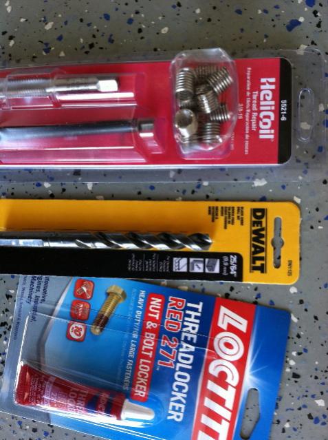

    I have a 2001 Air Nautique with a Gen 2 FCT tower. One of my tower fold down bolts was striped out. I used a Helicoil and fixed both sides in about 30 minutes. I've never used a helicoil and it worked perfectly. I bought a 3/8 x16 helicoil kit on Amazon (http://www.amazon.com/gp/product/B0002SRDVE) for $15 and got it 2 days later. I had to buy a 25/64th" drill bit to drill out the existing threads and some red Loctite. I used two helicoils back to back to make sure i had a long enough thread for the bolt to hold securely... One of the easiest fixes I've done.

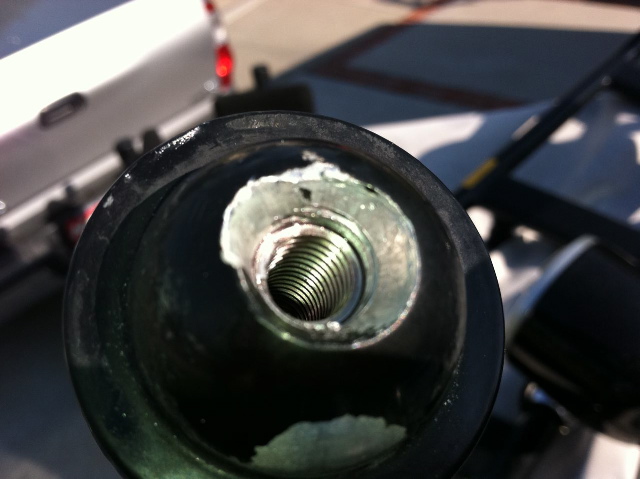

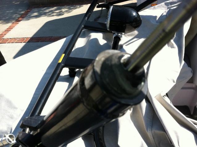

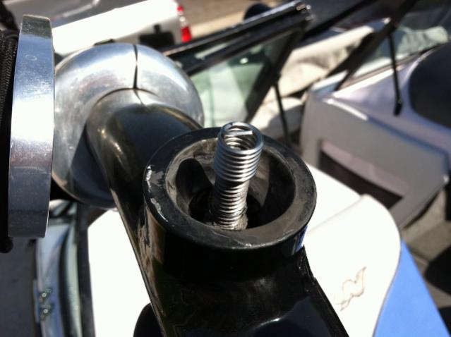

          Sorry if it's a little blurry...Only had my phone camera. In the first pic, I was testing the Helicoil to make sure it fit the 3/8" locking bolt. Second pic shows striped out threads. The third pic shows the hole after it was drilled out. Fourth pic, cutting with tap. Use oil or cutting fluid for lubricant. Start firm, but slow, to make sure it goes in straight. Occasionally backing it out to vacuum out metal shavings. Last pic, finished threads. I carefully sprayed out the oil residue with brake cleaner and vacuumed it out to make sure the loctite would bond with the metal. Finally, I put anti-seize grease on the bolt after the loctite cured and re tightened.
