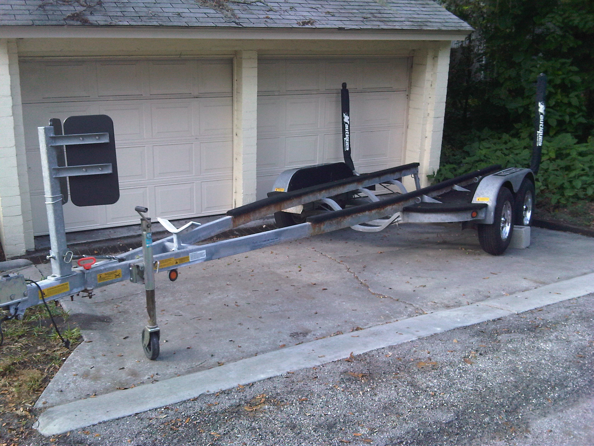

Is there much difference in the hulls or any at all? Would a trailer used for a 99 210 SAN also fit the newer 2008 SAN 210?
RE: 99 210 SAN trailer going to fit a 08 210 SAN?
My friend used my trailer from my 2000 SAN 210 for his new 2008 SAN 210. They have no problems fitting the boat. They trailered their boat in/out of the water until their new lift arrived. Good luck!
The new 210 has the widest beam of the new series boats. Unless the fenders are set far enough apart I bet it would sit on top of them.2001 Super Air Nautique
Also 07+ 210 need to be supported in different from the older CC.
If that is the trailer being used in the pic, I would really be cautious of the corrosion I see under the bunks. I saw a trailer that looked almost exactly that way (with what looked like surface rust) and when the bunks were removed the main frame rails were rusted through the top, and the insides were not too good either. (yes it was a galvanized trailer also). Just my .02
