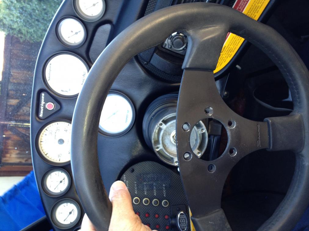

                  You need to pop off the plastic center hub cover to reveal a large nut. I think it may be 3/4" socket. I used a deep socket but maybe a std socket is OK. Remove the nut and washer, pull steering wheel up off the spline, center and replace all.

                    You can also adjust the steering wheel clocking by where the aluminium tube is clamped back by the rudder. But you want to make sure the rudder turns approximately the same both ways.

                      Originally posted by JayG80 View Post
                      Negative on using an allen wrench. Those allen heads are just decorative.
                      If you don't know what you are talking about you really should refrain from posting incorrect data correcting somebody that owns this boat and knows...
