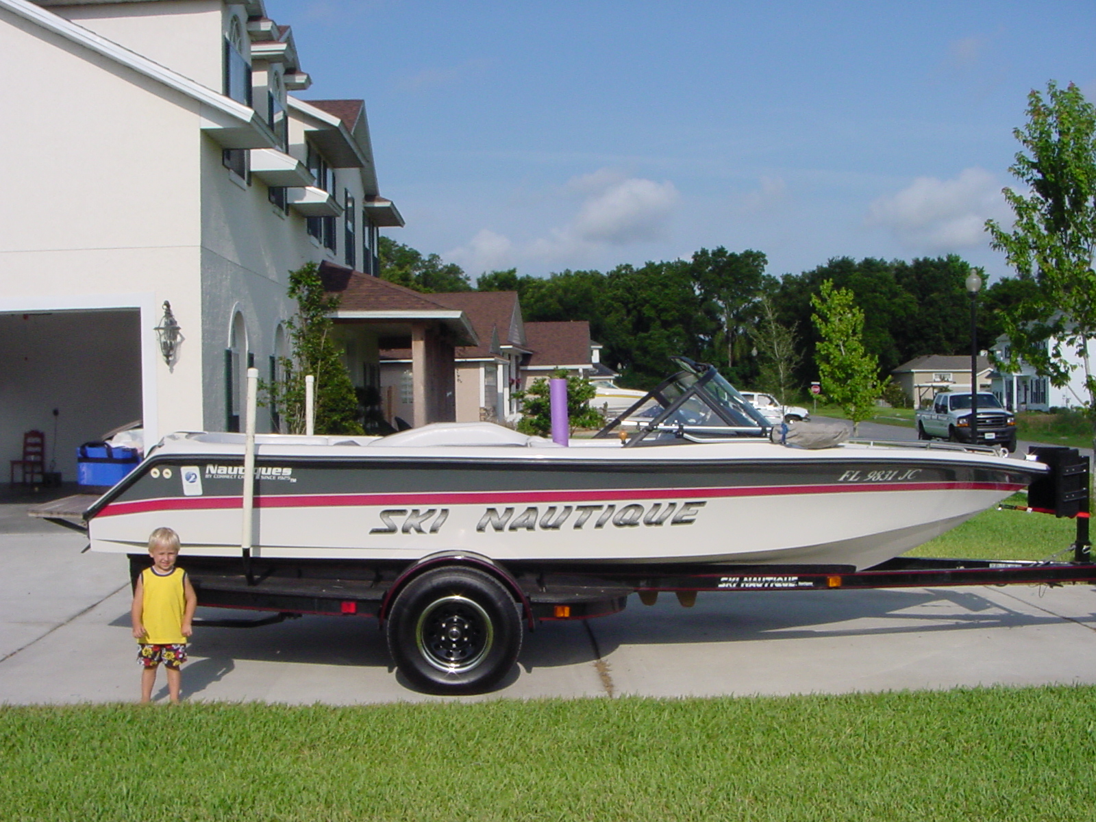

          See photo for curve in winshield.

                Just out of curiosity - due to the picture clearly depicting a curve/radius at the top edge of the windshield - what is the hull/cc ID number?
                Could it be mistaken that it is a 1990?

                  Windshield
                  Pic of a 94 SNOB Windshield
                  I was under the impression that the windshield went to the curve style in 94

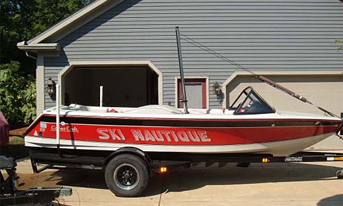

                    The red/black boat above is definitely a '90. Same windshield as my '90. The glass itself is flat. I promise.
                    The curved windshield shown on the gray/red boat did debut in '94. Totally different windshield.
