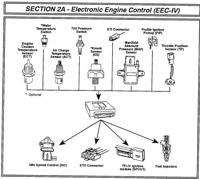

    The theory here is pretty simple. The sensors monitor various parts of the engine and the EEC is the computer that reads this informantion and uses it to control parts of the engine. The below diagram lists the sensors and the control items. Click image for larger version
