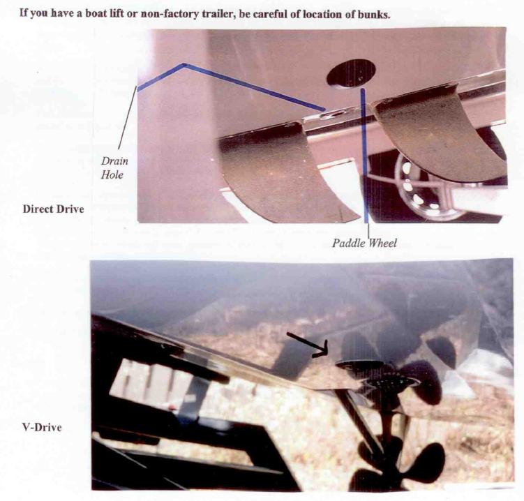

    I plan on ordering PP Wakeboard Pro next week. Does anyone have pictures of their install of the paddle wheel? I want to get the location right. Also, can you use 3m 5200 fast cure to seal it? Thanks.

    Here are the pictures that came with my manual. I believe 5200 would be the sealant of choice, but I did not do my own install.

              Look at pic DSCN3521_small.jpg here: http://www.planetnautique.com/index....pic&t=2949. It looks like it's about 12" in front of the RWI.

                Keep it well away from any water intakes. 12" should be ok, but the PP does disrupt the water just by being there. Also, measure 8 million times before you drill that hole. Then double check it. 5200 is a good choice on the sealer, that stuff is great.

                  All the pictures I've seen of the installs show it on the port side, the same as the RWI. I don't believe I have any water intakes on the starboard side, why not put it there?

                    No reason. Put it where you have room to work. I cannot remember who posted the magnet trick for lining up your hole in a good spot. Try a search, it may have ben Wake_fun.
                    Measure, measure, measure, double check, then drill.
