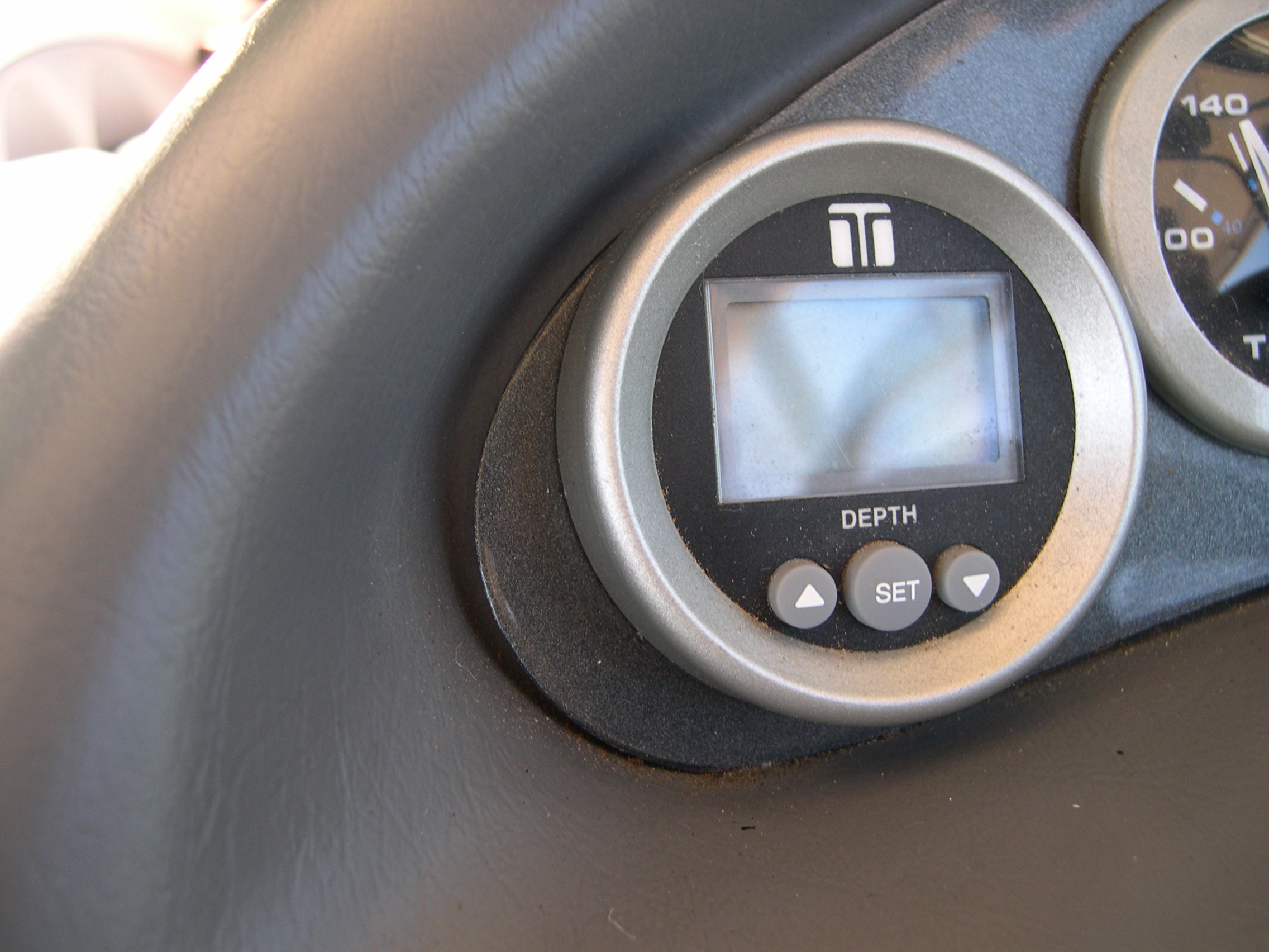

              Thanks for all your help, is my unit a Teleflex or a Hummingbird? It has a small "T" on the top of the gauge. See it in the picture.
              If I do go with a oil bath, which one will fit and look similar to my old one.

                It looks like the same one I have. On mine, pressing the set button toggles through a few modes: shallow, deep, keel offset, & then back to depth reading.

                  The 'T' icon is a Teleflex. The Hummingbird will have 'Hummingbird' wirtten out on it usually. Sometimes they will also have either or for the transducer. I am convinced the hummingbird and the teleflex are rebranded chinese made components. If you look at most depth finders, they function similar, look similar, and the transducers are very similar.
