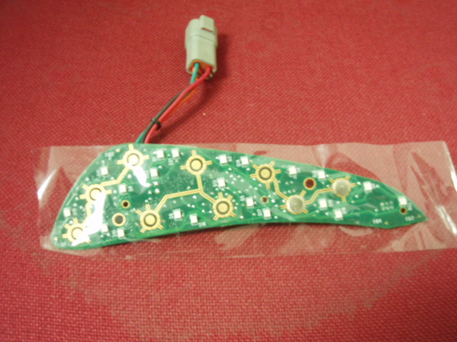

                    2 nd keypad repair
                    last Sunday, I can't key on my 01SAN , no response when input code, noticed that the ACC. keypad lamps lighted not regular, I unplug ACC. keypad, the code keypad can work ! I have a good Sanday ! the code input keypad I repaired on Feb, still good , http://www.planetnautique.com/index....amp;highlight= the problem is the ACC. keypad, I bring it and of course had it surgery,foun water go to PCB,so I clean it with ulatrsonic clean and solder over 40 corrosive points , tested to boat 2 times,now I had it fixed.
