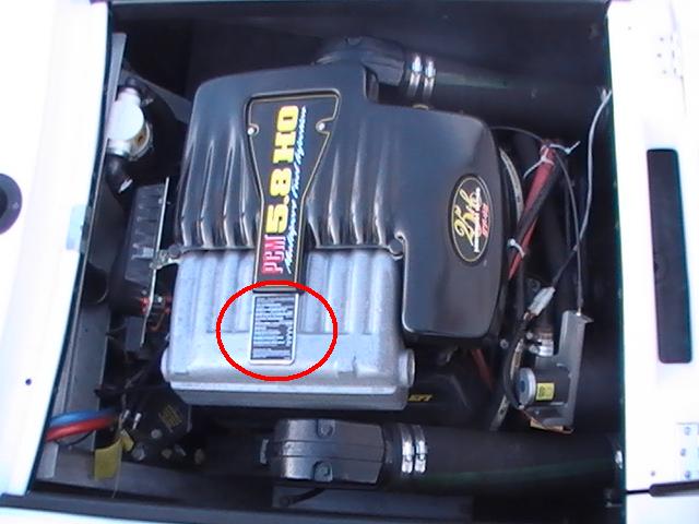

      There should be a spec on top of the engine that I believe says 89 octane is recommended on the GT40. (see pic)
      That being said, when fuel prices went thru the roof I contacted PCM and they informed me it would be no problem using 87 octane in that motor, which is indicative of your article. I'm not making any recommendations, but that was good enough for me to buy 87 on occasion.
