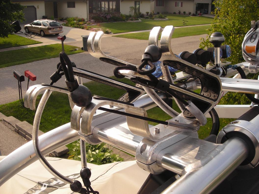

    Are yours through-bolted in? Most of the flight clips use an oval bracket. But anyway, most people have them mounted on the side bars not the top. The ovals are exactly the same. Those are flight clips on my 2nd gen FCT in my avatar pic.

      If yours are through-bolts and not clamped, then measure thrice and cut once. Get some helpers to hold them in place and try filling up both slots with boards and bindings. There are very few placement options that will allow your bindings to fit on the inside rack. I found that mine needed to be most of the way forward to work, otherwise the binding would hit the rear vertical bar. Even so, closed toe bindings tend to be an issue on the inside, so I use wakeskates and/or open toe binding boards on the inside.

              They are flight clips if they look like this (disregard mounting ovals).
              My boat came with what looked pretty stock, but was not flight clips. It had a block and pin similar to what you describe, but it was something other than flight clips. There was no recession, however, in my tower.
