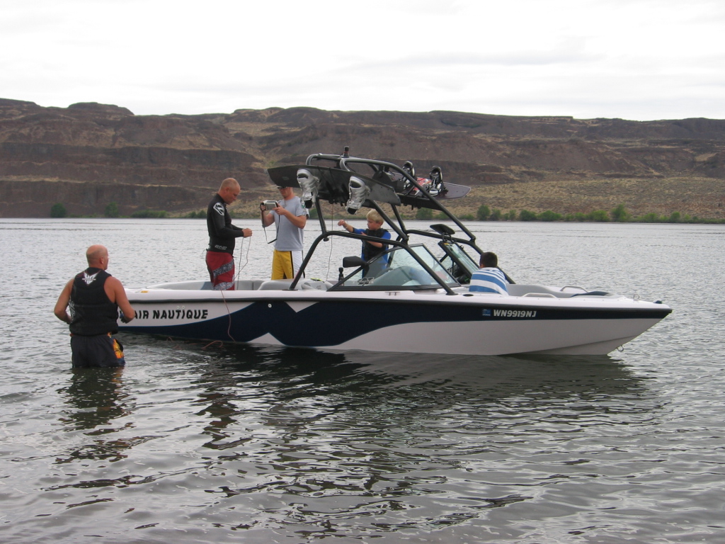

    I have owned my Nautique for a year now, was very afriad to touch anything until this year. I have already changed an impeller, fixed the leak in my cold water shower connection, and found that my raw ater strainer had no gasket( thanks for the heads up PO). My first question is what model do I have? It is an 01 open bow DD with 2 rear ballast tanks, I have been reading a million posts and cant figure out if I have an "air" or a "pro air" I know its not a "super air" because of the DD? Second question, I would like to add a second battery, how difficult is it, are any special tools required. My current battery is directly under the front bow cushion.
    I will try to attach a pic
    Thanks

    If it's an Air, it's not a Pro-Air. A Pro-Air will have strakes in the Hull. Possible it is a modified Sport, which for all intents and purposes is an Air..

          What is a Strake? Also the graphics on the side say "BIG AIR NAUTIQUE", the orig owner didnt like the factory graphics and had that put on, you cant see the BIG in the pic cause my fat ars is blocking it. Now I do have a notch in the back bottom of the hull, is this a strake?
          Thanks
          • nms1991
            • Apr 2004
            • 477
            • Unknown
            A strake is a design in the hull to lift at a certain speed and it would be toward the middle and it would also have a cutout in the hull bottom below the big N in the side of the boat and it would look triangular in shape and cut towards the center of the bottom of the hull.
