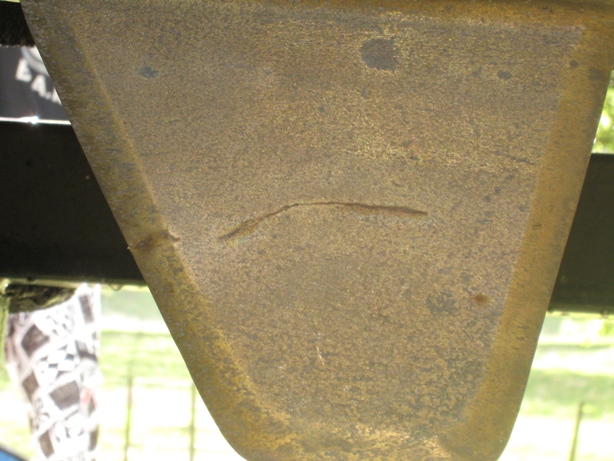

I'm told it's just a mold defect and nothing to worry about but to me it looks like a hairline crack? Boat is a 08 210....what do y'all think?

looks like a crack to me. Take a large crescent wrench and put a little side to side force at the bottom
and see if it opens up the crack. The skegs are covered by the 5 year warranty so you have time.

crack. Is that two sides to the same piece?

That's a crack - bend it and if it breaks off - toss away the broke piece and with the pics as evidence
tell the dealer it must have broke off in the lake during a hard evasive turn. Same story if it only bends and separates.2006 SANTE 210 (Pending Sale)

Is it still under warranty? If so and the dealer is telling you it's a "mold defect" then he's giving you a line of BS! It's cracked!!!

Stop by a decent vessel, fabrication, or machine shop and tell them you'll give them 10 bucks to do a dye pen check.
They spray on a red dye and let it soak. Then they wipe it clean and spray on a white spray that looks like Christmas tree frost. It leaches out the dye from the crack. You take a few photos along the way.

You're amazingly smart Airtool. You should be an engineer!!! I think that looks exactly like a crack... I would tell them it needs replaced. ESPECIALLY the second picture where you can see the moisture coming out of it.Travis Fling

Like you and everyone else is saying, it looks obvious that its a crack. Have you tried tapping them, a cracked one will sound dull , the good ones will have a ring to them. Use a screwdriver handle or similar.
