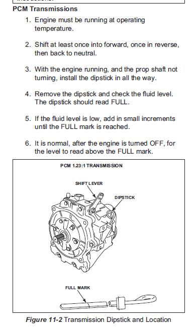

                I'm 99% sure the level should be checked with the engine RUNNING ....not off.
                Also be sure to put the trans in forward and reverse at least once after starting.

                    RE: Re: RE: Help Checking Transmission Fluid Level
                    Snapshot from the 06 manual.
