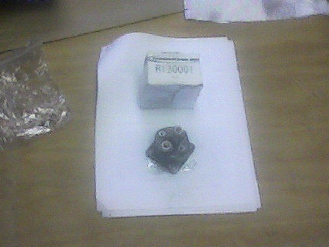

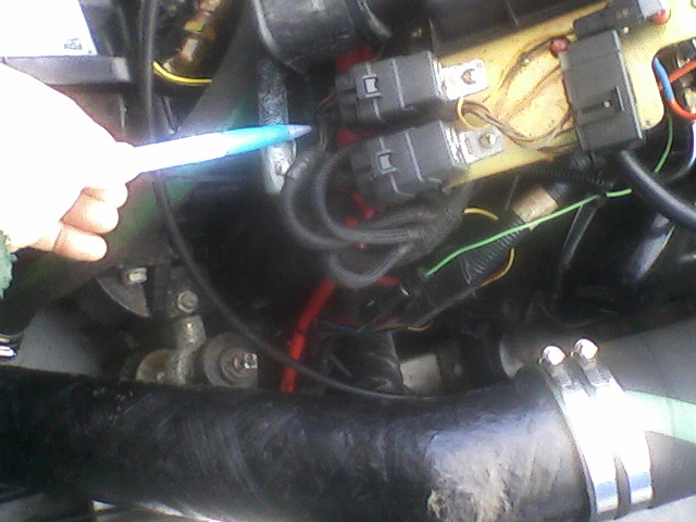

      GT-40 Relay locations
      Here are some pictures I took today.

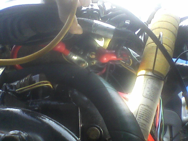

        assist relay location
        Here is where that relay is:

          Here is another picture looking up at the relay:
          • DanielC
            • Nov 2005
            • 2669
            • West Linn OR
            • 1997 Ski Nautique
            Disconnect the negative battery cable before you start to replace this relay.
            When you replace this relay, take very careful notes of where each wire is. Be careful you do not confuse brown and purple wires, if you have them.
            12 volts for the starter does not go through this relay. You should have 12 volts at the big red cable on the starter all the time after you are done replacing this relay.
