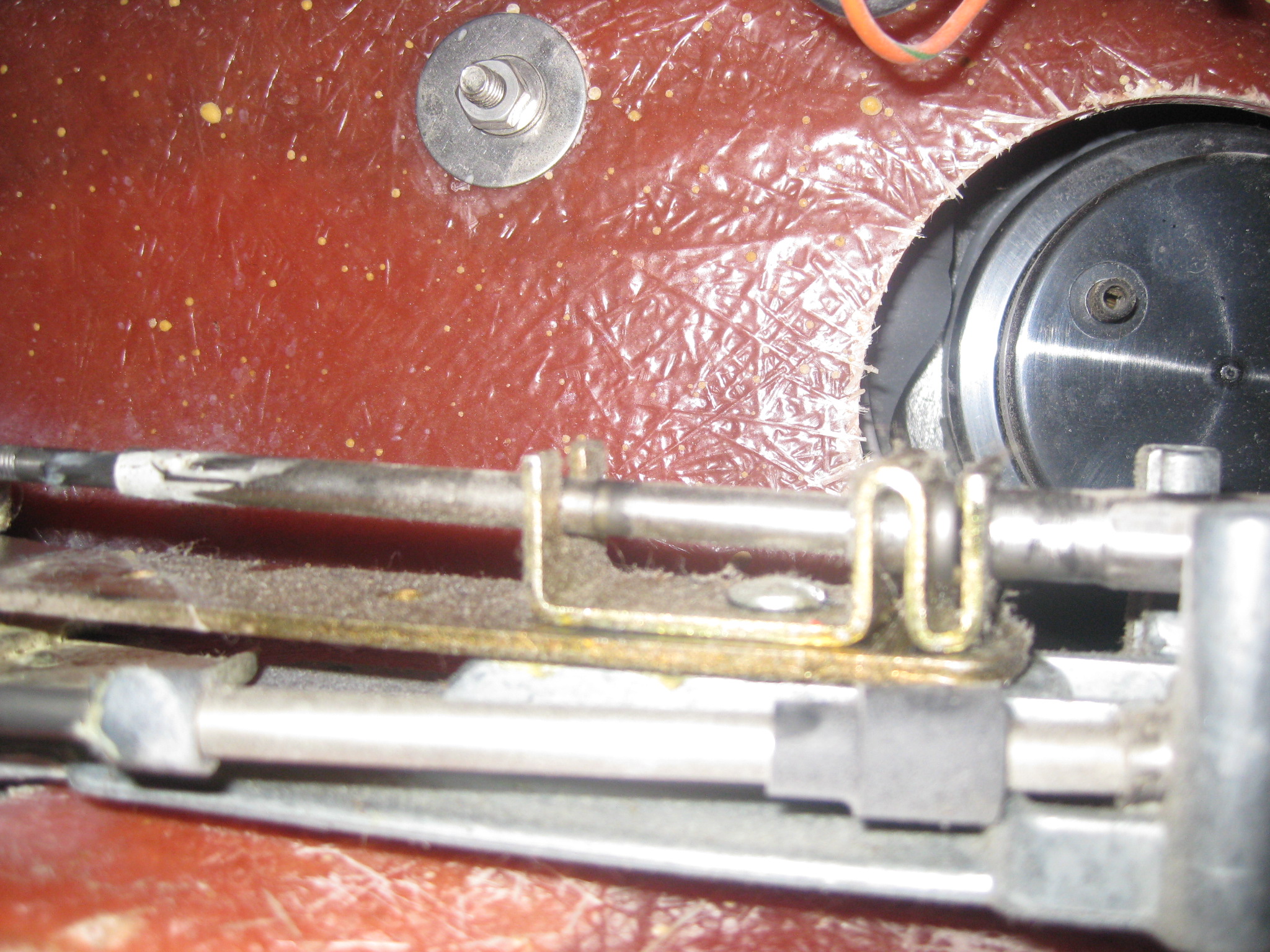

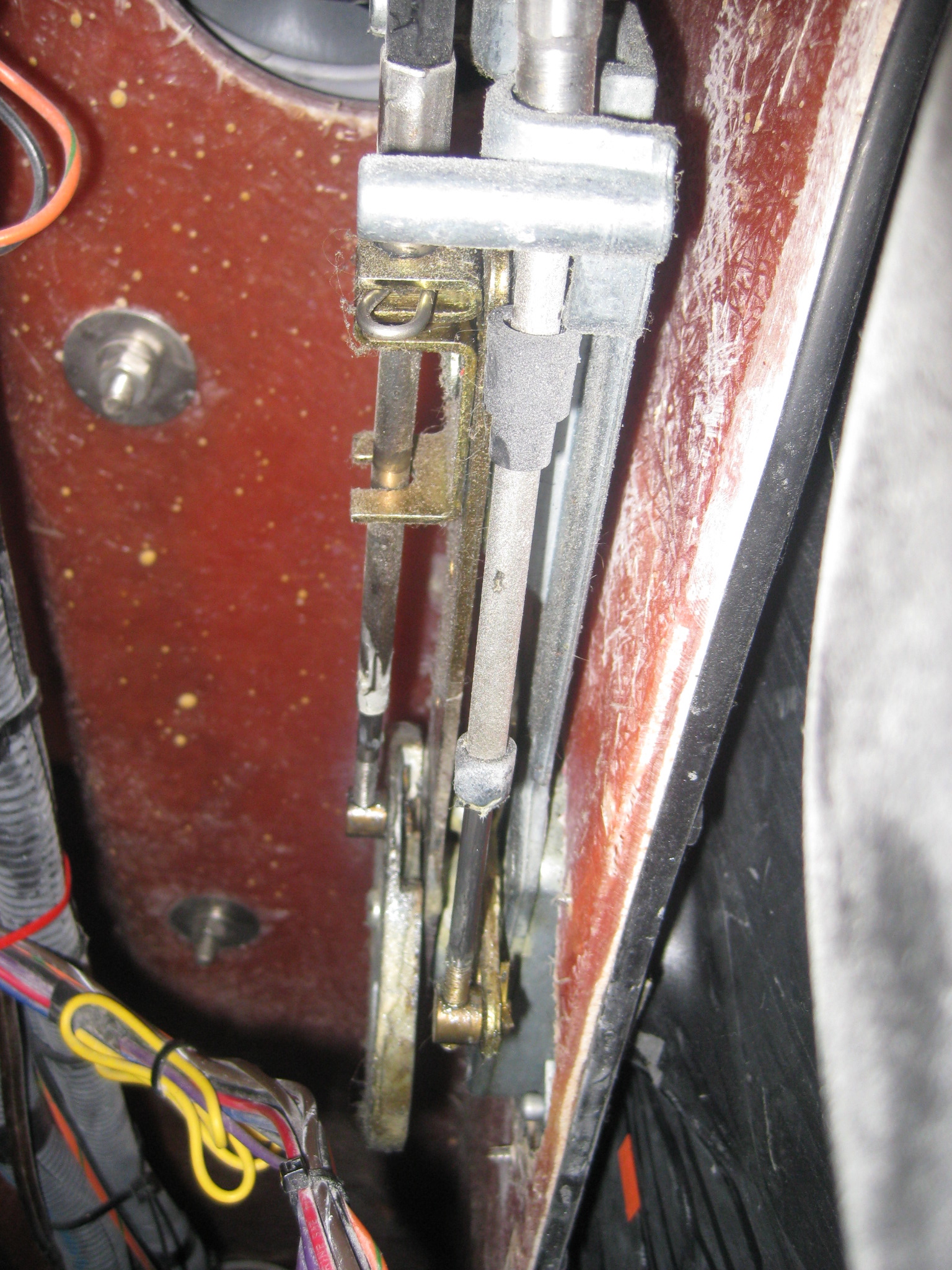

          Well I decided I would investigate a little more and fixed my problem. The throttle cable mounts to the assembly through a hole and is kept in place with a keeper pin. I noticed the linkage would bind when trying to go from neutral to in gear so I removed the cotter pins from the assembly and the lever moved smooth as silk. I then removed the keeper pin that holds the throttle cable in place and moved the cable back one slot. Now it dose not bind and goes in and out of gear smoothly. I'm attaching some pics so you can get a better idea of what I'm talking about.
          The first pic shows a close up view of the 2 different positions the keeper pin can be in. (Just under the cup holder) It was in the slot to the left moving the cable back. I pulled the pin and slid the cable back to the slot on the right and replaced the pin. The last 2 pics better show the whole assembly.
          Hope this helps with your boat tsimpon.

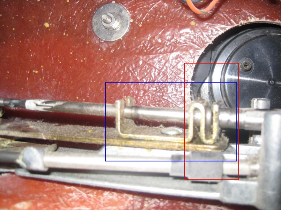

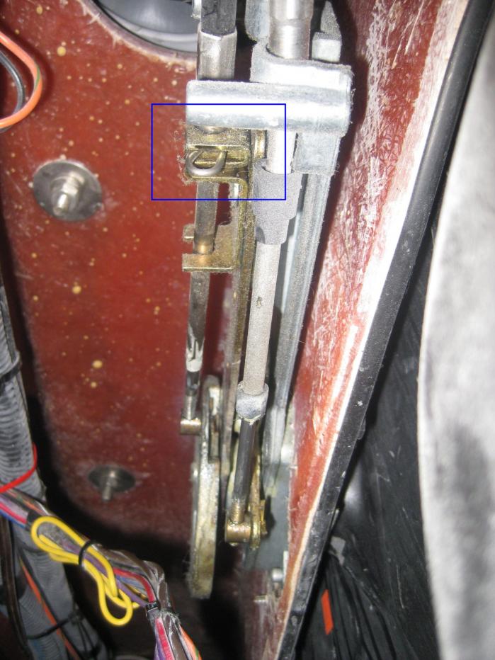

                            I'm having the same issue as Core-Rider on my 03 SANTE. Stiff going into Fwd & Reverse but after engagement, it is smooth the rest of the way. I can't seem to figure out exactly what is going on. I feel the binding/rubbing in the mechanism. Definitely not the cable or transmission links. Looks like there are two sets of plates (big fat washer looking shaped plates) and the smaller more fwd ones seem to be the ones causing the friction. Can you explain in a little more detail as to what you did?

                              Update with better explaination I hope...
                              pav, I drew squares around the area I was talking about from the earlier post. The blue square highlights the area of the linkage I'm speaking of. The red square is where the pin is I moved. As you can se the pin can be placed in the left or right slot. It was originally in the slot on the left. By moving the pin to the slot on the right and cable sheath moves back about 1/2". I believe the cable inside the sheath has streched just enough for it to bottom out in the sheath causing the "binding" I was speaking of. By moving the sheath back that 1/2" it no longer binds and there is no need for adjustment of the shift cable position since it was never moved.
                              The second pic shows the pin in the new location. As you can see it is in the rear or right hand position. The first pic doesn't show very well the groove in the sheath that the pin slides into. It is hidden in that pic by the mounting bracket. I had the push the sheath just slightly forward to line up the grove with the proper slot.
