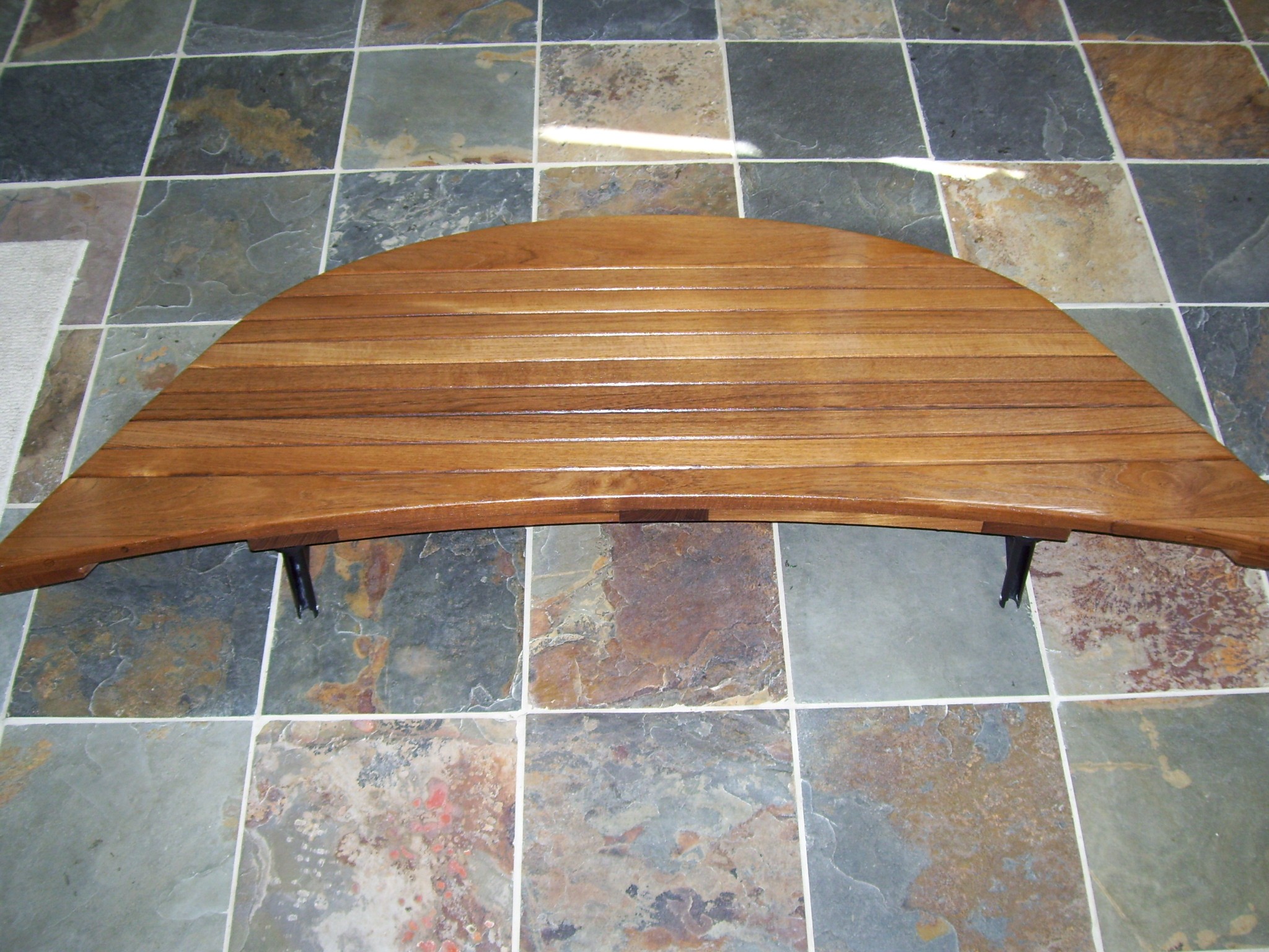

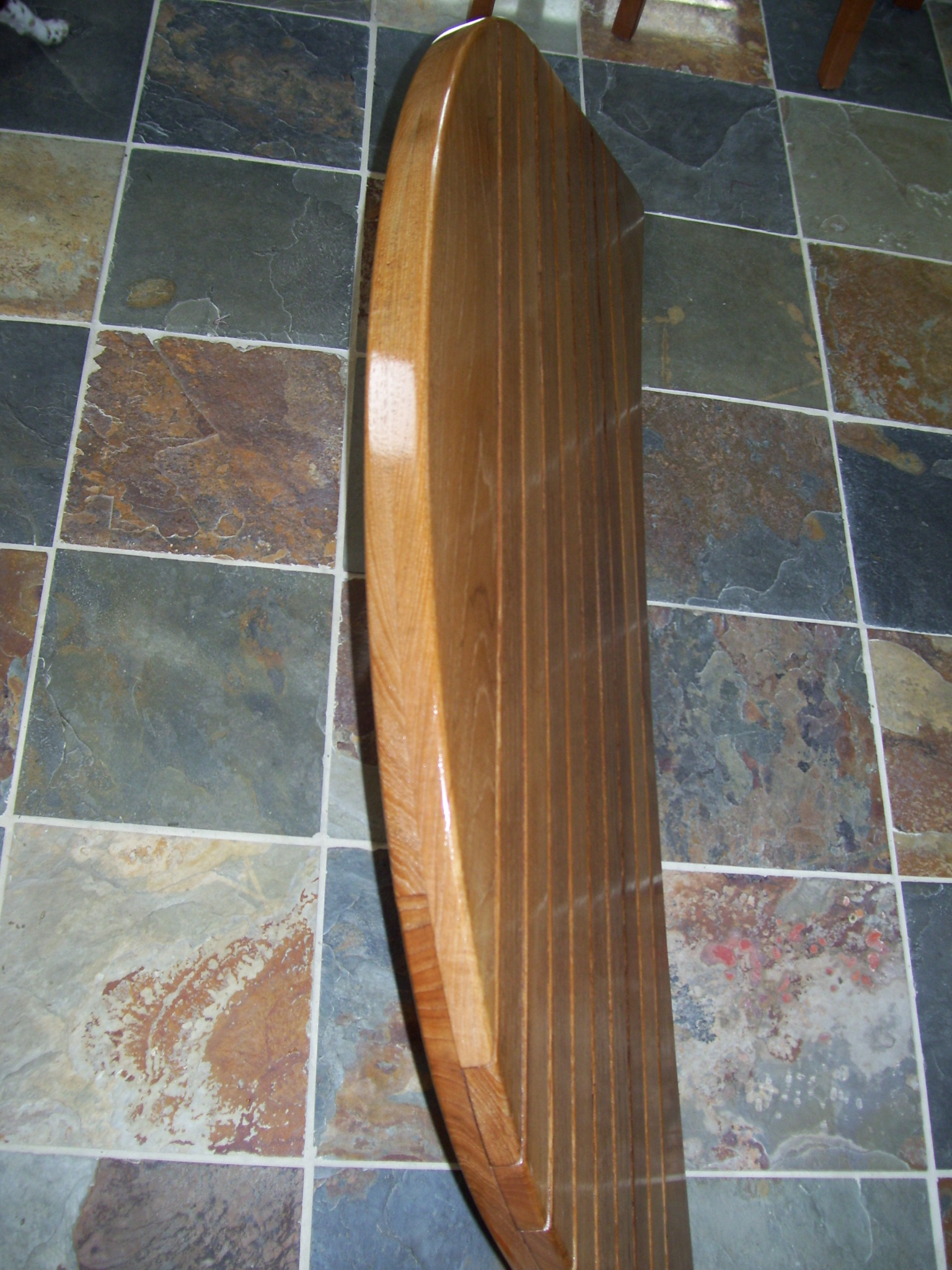

                It takes time to get that deep shine. I wet sand my platform in between each coat, which makes it smooth as glass. You'd think it would be like stepping on ice when wet, but somehow that's not the case. I probably put at least a dozen layers of oil on before I feel it's ready. Note: if you like that golden teak look, tongue/teak oil is the way to go. If you like a darker look, use linseed oil.

                  Do you wet sand right after the coat of oil or let it dry some? I assume you blow it off or vacuum it after sanding as well.

                    Let it dry completely. Bake it in the sun if possible. Then wet sand, dry, and reapply. It'll look slick, but it isn't.

                      man swc that looks like my hardwood floors. I am very impressed

                        That is BadA$$. Man, do I love the look of that platform. Unbelievable. This is why I love teak... all the maintenance is no fun, but when you see that, it's all worth it!
