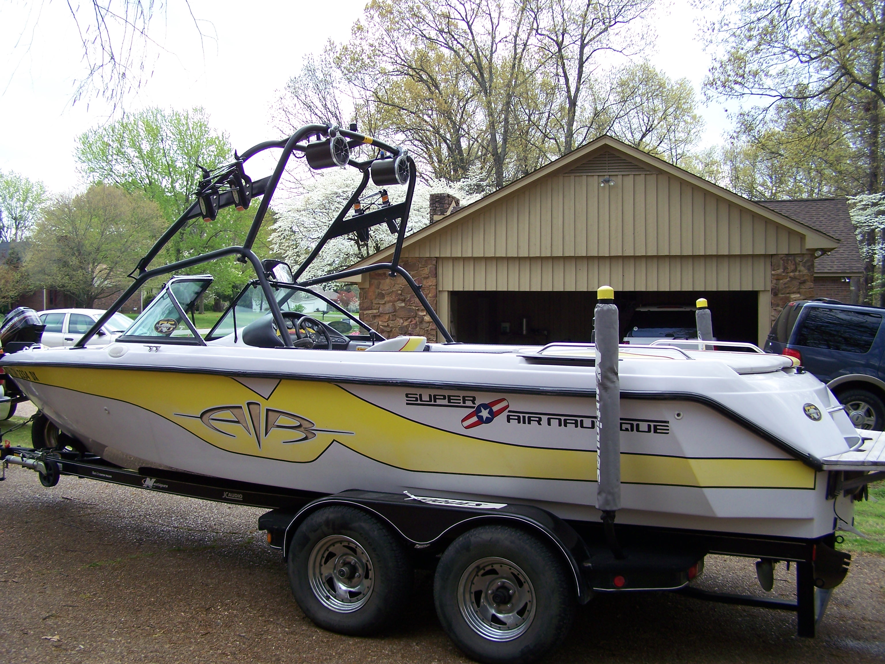

Is it possible to have just the yellow repainted on the sides of the boat and the AIR graphics replaced. If so about how much do you think it would cost and who could do it?

I know I shouldn't have to repaint it, I just bought it and it's bothering me that everything isn't perfect ha
RE: Having boat painted
Sorry - Pin Stripe. New Air Sticker. Some rubbing compound and the yellow will look like new. I'm a perfectionist too.

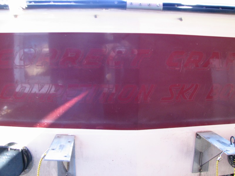

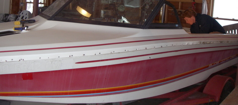

you wouldn't be re-painting it, there was never any paint there in the first place. Take a look at what some of the guys on this site have done to get 20+ year-old boats looking like they came off the production line and you'll see that you're actually in fine shape.
Here's an o.k. pic of an '89 supra we cleaned up last summer.
How 'bout a little reverse action...

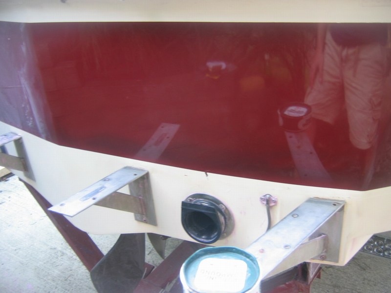

Ya I'm with squaminboards on this one. All you gotta do is wetsand that bad boy. If you don't want to do it yourself you can pay a marina or someone. But doing it yourself is not that hard its just long and tedious. This is what I did with the transom of my boat in just a couple hours.
