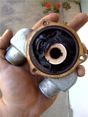

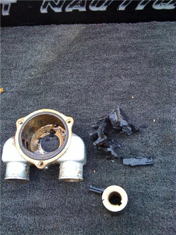

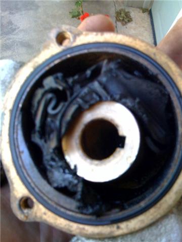

                        • NautiqueJared
                          • Sep 2007
                          • 32
                          • Houston, Tx
                          Well I got the impeller out (or what was left) and examined the inverta flow. Just looks like the it started to peel the thin spots where they wrapped the end caps but doesn't seem to be leaking. I changed out the plugs and cranked it up just for a few seconds without the pump attached. After a scare, I realized that I had switched up my 4/6 cylinder plugs(backfiring and sputtering)....once I got those switched back to the correct spot it cranked up with, seemingly, no problems. I checked the oil and luckily it was full and still a clean color even after a full season on the change.....going to get that changed before the next outing though. I checked the thermostat housing for rubber but found the remains didn't make it up the draw hose.....the thermostat is stuck open so I just left it in there.
                          Thanks for the reassurance and suggestions....oh and I already have a string tied to the steering wheel. I just get so **** excited to be on the water....forget everything else going on. Here are a couple pics(for your enjoyment) of how to truely destroy a impeller.
