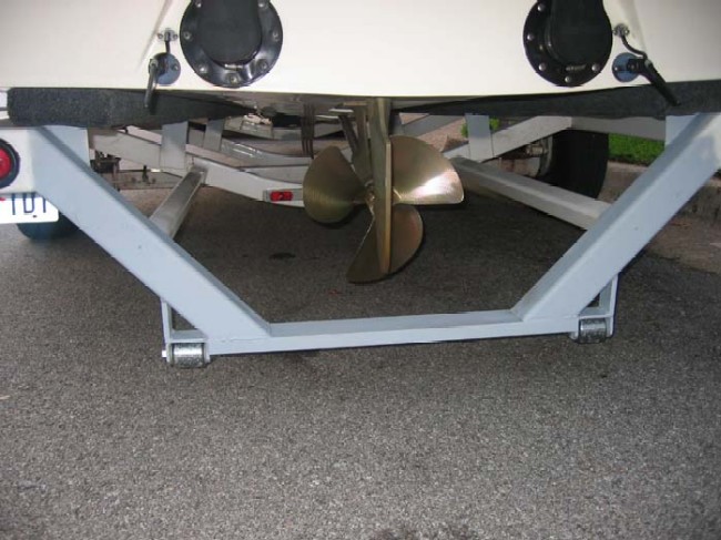

    I'm trying to get some prop guard rollers welded on to my trailer because it drags on my driveway everytime I take the boat out. I've tried calling around in my area to find someone to help weld these things on, but nobody has given me much confidence. Figured I'd check to see if anybody on here was near me and could help out. Here's what I've got and here's what I'm trying to get it to look like...

    I'm in the Charlotte area, and I modified my trailer the same way. I've got a decent mig welder that I could help you weld those brackets onto your existing trailer. I did mine, but had to do more fab work, wish I could have found those roller brackets! All you need in a couple of small pieces of angle with the brackets, grind the paint, and we can zip it up.

            Jack - here are the measurements that we discussed:
            Roller bracket:
            width = 2-13/16" - call it 3"
            depth = 2"
            Prop Guard:
            width = 3"
            height = 1-1/2"
            Based on these measurements, if we mounted the roller on the outside of the prop guard and the roller bracket is 3" wide, then I think the piece we weld going vertical towards the angle of the prop guard will have to be roughly 7-8" long... the angle of my prop guard is steeper than the one in the pic above. It's a Ramlin trailer.
