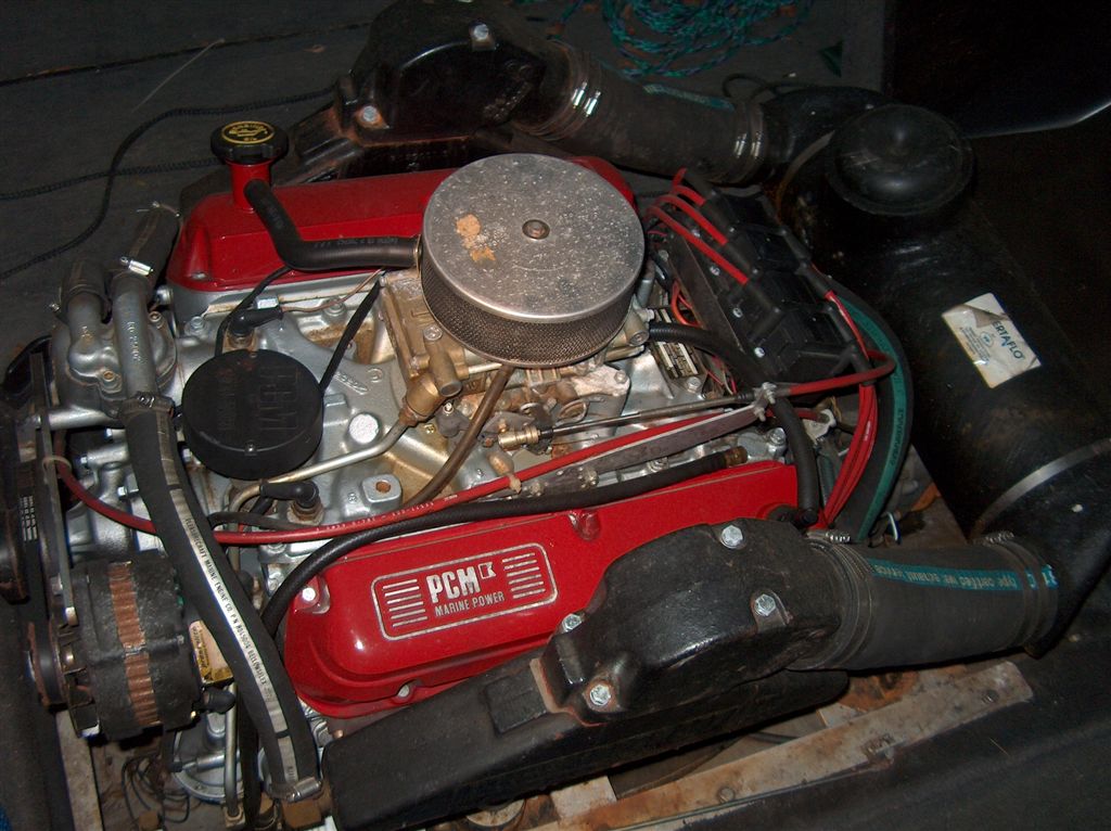

            RE: 1992 SN pro boss which prop?
            So How do I know what engine I have in my '93 ski?
            I know its got the electronic ignition.
            I'm not happy with the 470 (I was in Colorado though) So I'm thinking the 1442 might be the way to go.

              Re: RE: 1992 SN pro boss which prop?
              Britt, in looking at your graph you seem to be implying that the 470 is getting you to 48mph @ 4300 RPM? Something is very wrong with those figures- either your tach or speedo are way off. Take some pictures of the engine so we can help you ID it- and grab the model number off the tag on the intake manifold.

              • brittcrowell
                • Mar 2006
                • 17
                • Lake Jordan, Alabama
                RE: Re: RE: 1992 SN pro boss which prop?
                Mom gave me a sailboat a few years ago. It needs some gelcoat work, I'm way to lazy for that and poor to pay someone else.
                They very well may be something wrong with my tach. I don't doubt that my speedos are off too. Need to borrow a friends GPS to check I guess.
                I thought the RPMs looked low when I dug out this file the other night. But I found the original data in a old notebook and its indeed what I originally wrote down.
                I've got a cousin with a high end Fluke thats a mechanic, we can check the tach with that.
                I was originally worried about turning too many RPMs with the 470 when I moved back to AL from CO, but I guess thats not the case?
                What RPM should I not go over?
                So how many RPMs should I be tunning at WOT?
                The engine model number is: PLP-PR-R12PT
                According to a post of yours on CCFans TRBenj, I have a left handed ProBoss engine mated to a 1.23 tranny.
                So is thats the 285hp model?
                Thanks Britt
                  Britt, thats correct- you have the 285hp Proboss. Do get a GPS on there, the 48mph is possible, but probably a tad optimistic. If thats in the ballpark, 4300 is definitely way off the mark. I would expect you to be turning that prop close to 5000 RPM. The recommended max WOT RPM for the HO 351w is 4800, so youre not much beyond that. The 351w has a strong bottom end so I wouldnt worry about it- I turn mine 5200+.
