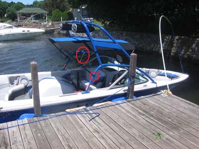

I bought a Bimini tower a few years back and it didn't come with any mounting brackets. The tower is a Towers Bimini and i was hoping someone could snap me a few photos or give me part numbers of what i need and tell me some place where i could buy these mounts. I'm also baffled about where the little 12 inch "leg" at the rear of the tower mounts up into the fabric top. I've looked online for images but can't find any up close shots of these brackets. thank you for your help. I've attached a photo of the areas in question.

Our TB has three "U" shaped bars, the front mounts to a bracket attached to the FCT, the rear is the same attaches to FCT at low point you circled on pic , the center bar attaches to the rear bar, high point you circled in pic, at that connection there is a short +/-12" straight bar which also attaches to the FCT.
This pic you can see the front bar mount and the center mount for the 12" straight piece:
This pic you can see the Rear bar and Front bar mounts:
