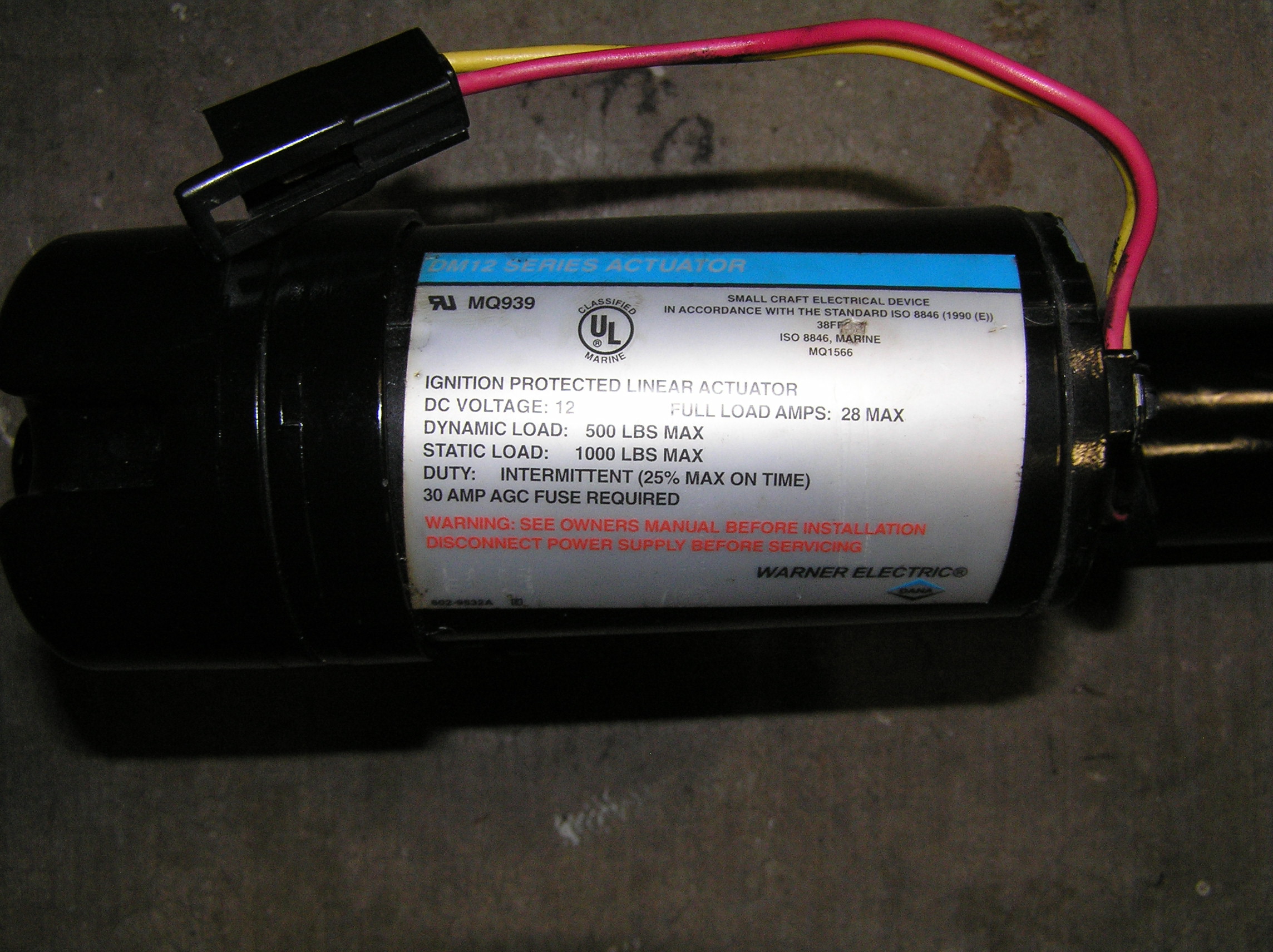

          Here is a picture of the actuator motor. Looks like a Dana/Borg/Warner product. States that it is a DM12 Series actuator.

                        Ok, I had to replace the switch for the actuator on my '99 NSS when I bought it last year. So, my thinking is that maybe the switch is shorting out in the "close" position only. You know, maybe energizing "close" and "open" signals at the same time. I can see how this would make the motor buzz. I cannot see how the actuator would fail in only one direction.
                        The switch is hard to find (DPDT toggle). I got mine at Grainger (1XWT8). Problem is the Grainger sourced switch had a slightly shorter neck, so I had to carve out a bit of the back of the gunnel so I could get the nut in place. The switch was $12.01. My local CC dealer was stumped on the switch, or maybe I was just in a hurry to get it.
                        Also, the factory switch has 6 spade terminals and 6 wires. Most of the DPDT toggles you might find have 5.
                        FWIW: It appears that my bro-in-law's MC 230 has the same actuator. Maybe MC sells it cheaper.

                            A friend of mine has a large motor pool at his company that supports heavy equipment. They know actuators inside and out. I am having them test it. If it is good I will work my way back through the relays and switch. I'll keep you posted.

                              No relays, just a switch.
