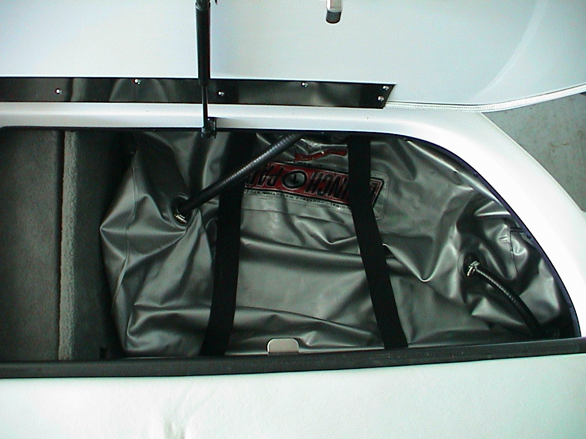

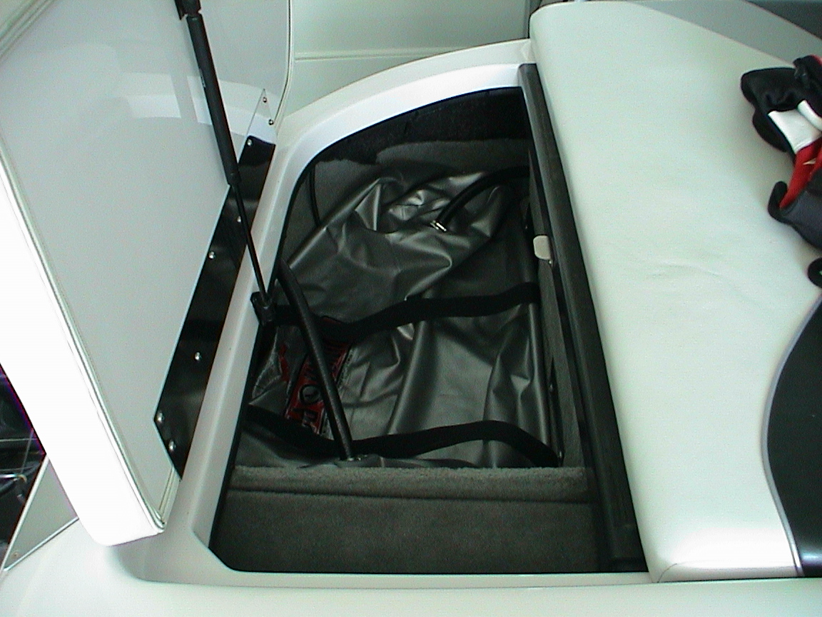

              i have a 12" sub in both rear lockers. They haven't done any damage to the tanks. This is a crappy picture, but you can just see the edge of the box. The speaker is mounted at a 45 degree angle, facing the gunnel. The box sits directly on the tank. The sound vents pretty well through the open spaces in the gunnel. It takes some good power from your amps to get any real volume, because of the closed compartments. I have 300 watts a piece (from a zapco amp) pushing each 12".

                  Bowvan, do you have sacks on top of hard tanks?
                  • bowvan
                    • Aug 2005
                    • 100
                    • sacramento
                    #24
                    Yes. They are the flat tanks, which are slightly smaller than the wedge tanks.
