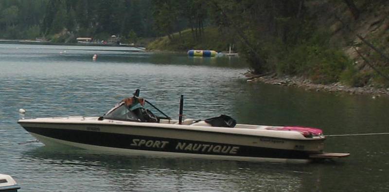

        Here is a picture of her pre tower. I would really like to chat with someone who is an advanced wakeboarder who has riden behind this boat or a similar model. Im excited to hear some reviews on the wake.
