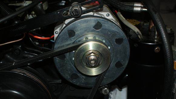

    Is there a way to tell whether the alternator in my boat is the stock 50 amp or the upgraded 100 amp without having access to any numbers? I know that it is not the original. It seems big to me, but what the heck do I know. It doesn't really look like either the 50 or the 100 on the White Lake web store, although I'd say it looks more like the 50.
    It was replaced only shortly before I bought it, but the seller is now out of the country for a 1-2 year trek across Australia, so asking him is not possible. I'm guessing he burned the original one up powering his cranking battery plus 2 deep cycle batteries, which were only on a Perko switch
    I did take some pictures.

      Are you even sure it is marine? Looks odd. Nothing like any of mine and I have a spare 45 amps 1988 PCM type. one 70 amp 2003 PCM and the new 100 amp pcm. None look anything like that. i hope someone didnt put a standard car alternator on it.

        100 AMP
        Not sure if this will help but this is the 100 AMP that came from SECC 2007

          Is your output wire is 4 gauge? If so its a good bet its 100 AMP. If you have a 10 gauge its probally the 45 or 50 stock amp

              It would not surprise me if it is a car alternator. The last owner was a royal dip. The boat has a 4 channel Alpine and a mono Alpine amp already. Both car (not marine) under the observer seat. I bought the boat last summer and it ran fine. I never really cranked the tunes though, as the last owner had also installed a car head unit, which would clip in and out because it was totally corroded. The motor ran perfectly however.
              The last owner worked for Chris Craft (not Correct Craft) and his Chris Craft mechanic probably placed this alternator in there. He did all the annual maintenance.
              If this is a car alternator, what kind of problems could it cause (other than just burning itself out)? Could it mess up the engine or electrical system some how? I hate to replace something that appears to be working fine (as there are many things to replace already that definitely need fixing). But... I don't want this to be a ticking time bomb either.

                you can blow up
                the internals are not sealed for sparks!

                    I think Jaybird is right on the automotive alternator. JIT is right too, your boat can blow up. same is true with starters, and distributors that are not marinized. Change it out. You need to worry about this stuff more than your stereo system.

                      Dang! Thanks guys. I must have something important to do on Earth, because it sounds like I was unknowingly really pushing my luck last season, and to have not blown myself up can only mean that someone is looking out for me. Not only am I probably running with a car alternator, but when I inspected the engine today, I found that the exhaust hose to the blower was completely disintegrated! Can I just use standard 3" black flex hose for the blower line (looks like a dryer vent hose but smaller and black)?
                      I will definitely pull the alternator now and see if I can find something on it to indicate what it is and whether it is marinized. Oh well... what's another $320 bucks.

                            If the previous owner was a chris craft mechanic I would expect the alternator to be a marine alternator. Based on the other things you are finding, I would not be surprised if it is a 100A alternator hooked to the 50A wiring harness? Look for melted wires.
                            If there is a spark arrestor screen covering the vent holes at the rear of the alternator it a marine unit. The main difference between car and marine alternator is the spark arrestor. All electrical components in the motor compartment need to be "ignition protected" so they are not capable of igniting a fire.
                            For the blower, use blower hose, not exhaust hose. Sounds like the boat may have overheated?
                            For your speakers, you might be able to front load your existing Pioneers (from your other thread). Some of the Pioneer speakers are tuned very brightly which works well in a boat. If you front load them and add a sandwich your stock panel with a metal or plastic ring on the backside it might hold everything together, cracks and all. With the added backing ring the stock panel should have adequate support for the heavier speakers. The Polk MMC's are quite heavy, that's one of the reasons amoung many that I prefer to use the db series (the db are much lighter). Infinity Kappa's are also very light but you need to be careful with their 2 ohm load, and you need to deal with the crossovers too. Using car speakers in boats is nothing new, if you are in salt and your speakers get wet, you should stick with marine speakers (JL, Polk, etc.).
                            Please check that heavy gauge wire coming from your alternator to see if it's melted.

                              I will be down at my boat again next weekend and check the wires. I'll probably pull the alternator to see if I can find some numbers. I guess if it is a 100 amp marine alternator hooked into a 50amp harness, hopefully I can just find a 100 amp harness to replace the 50 amp harness. The boat ran beautifully last summer after I picked it up. I took it out about 8 times. However, I never cranked the stereo (as it was giving us problems). Looks like I threw the dice 8 times and fortunately did not come up with craps.
