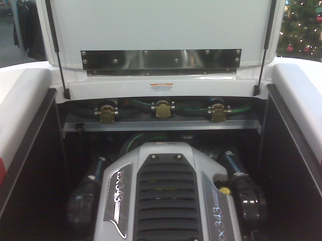

There are one way valves on all vent lines, so air is getting in somewhere. I noticed that the fittings were leaking some water so I used pvc glue on all quick release fittings to stop that.

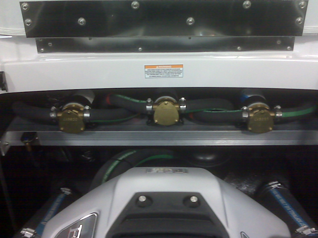

Changing the impellers should not be to hard. I have to take the rear seat back off and take 4 mounting screws off and I will have access to the impellers.
