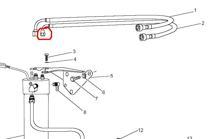

    Ran into a problem during winterization this weekend and need some info. The FCC on my 03 SANTE with 330 Excalibur motor is a bit hard to drain because the remote oil lines run right below it. So I decided to remove the high and low pressure fuel lines so that I could remove the canister and drain the fuel. When reinstalling the lines, I tightened the low pressure line too much and the brass fitting on the fuel line cracked.
    Any idea what is involved in replacing this line? I didn't see a joint anywhere on the line where it could be replaced. It appears to be a single line that is part of the fuel rail. Any ideas would be appreciated.

      Attached is a clip from the parts manual that shows the fitting that is cracked. Unlike what the diagram shows, the other end of the line goes to the fuel rail and I didn't see any place where is seemed to attach of connect. It simply looked like an complete single unit. I'm hoping that this is an easy fix and I've simply overlooked something.

          The line fitting that is cracked is the return line from the fuel rail back to the FCC - low-pressure line was the wrong way to describe it. I believe that the return line is lower pressure compared to the line going to the fuel rail. I remember when removing the return line, that it took no effort to remove the fitting, while the supply line to the rail was on fairly snug.

                  Ended up talking to Richard at Skidim about this fuel line. I have sent several e-mails on various items, called them on the phone, and placed several orders with them over the last couple of months, and I have had nothing but great experiences with them. Awesome company to work with. Anyway, that fuel line is replaceable and not all that expensive - less then $40. When I go back up to the lake house, I'll work on that and some other projects.
