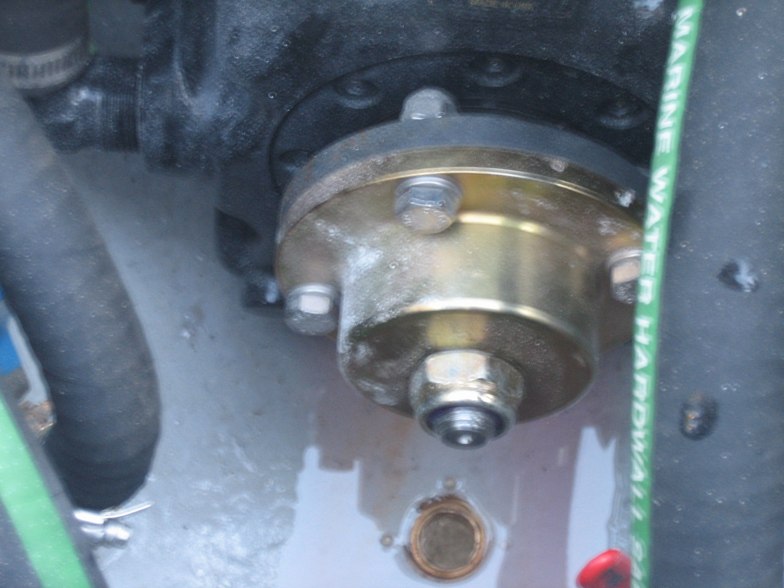

-Transmission plug was right by the hull drain plug (use a 1/2 inch ratchet drive)

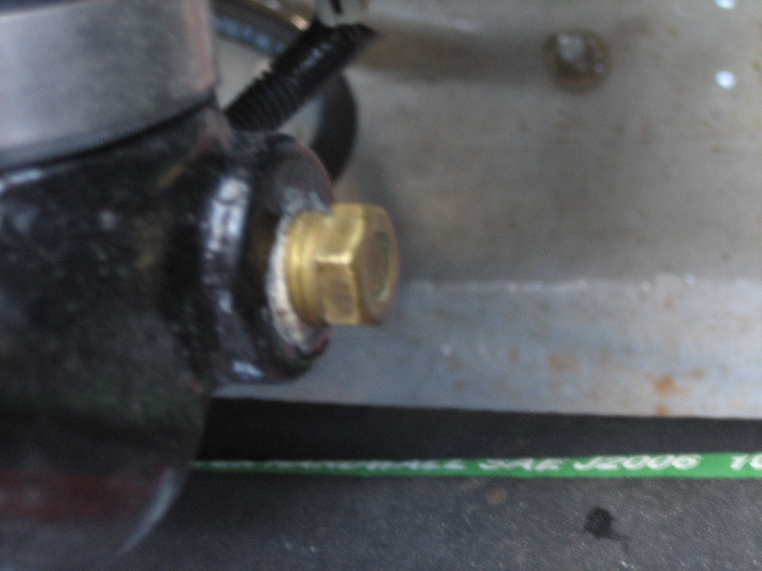

-Exhaust manifold plugs on each side of motor

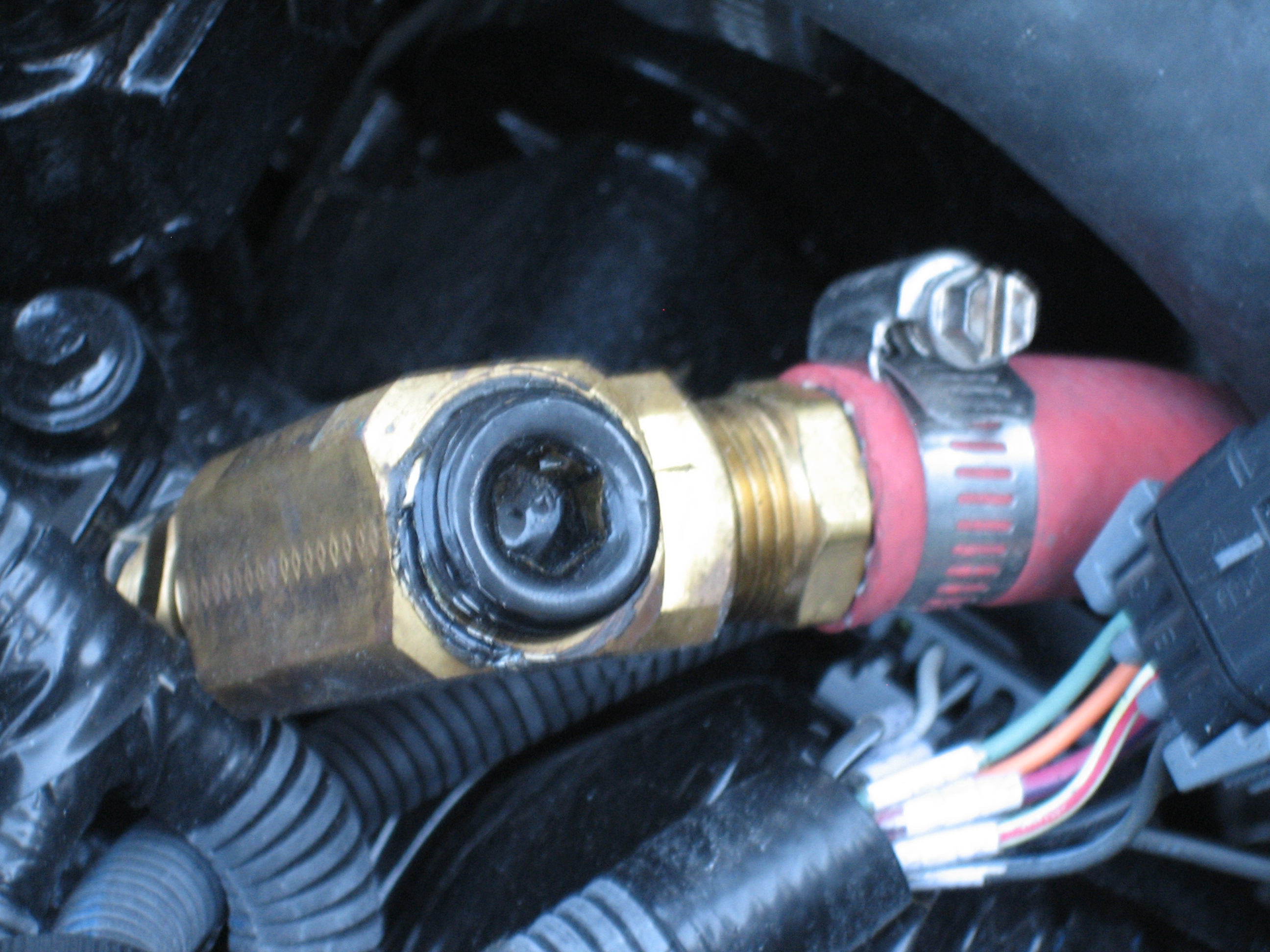

-Raw water pump elbow plug
-Engine block plugs hand-spun right off with knock sensor still attached
