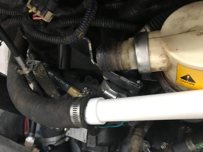

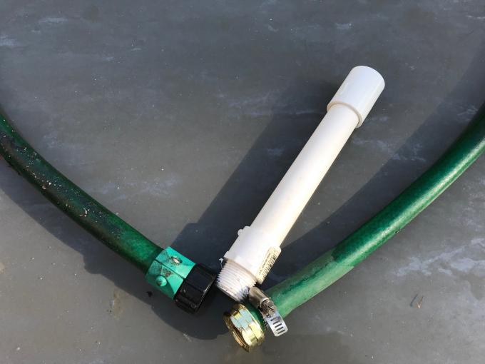

          Here is a very simple solution: 3/4" PVC pipe with male thread adapter plus a 3/4" coupling. then put two female ends on a short length of hose. Disconnect the hose that goes from the filter to the impeller and put the 3/4" coupling into that hose and clamp. Connect the water and you are all set. See pictures cost maybe $3 Adapter

            Made this after a lot of PN research. I don't keep it in permanently but you could. Disconnect hose from strainer to pump, Insert this, held fine by friction no clamps necessary. With the garden hose on and the boat off it pours on the driveway and doesn't force water into the system. Turn the boat on and the water is all sucked into the engine, again without pressure.

              I presume the clear hose out the top runs overboard and allows excess water to be diverted?

                Yep it goes backward through the strainer and onto the driveway. Clear hose directly to the strainer outlet the gray hose barb connects to the hose leading to your pump.
