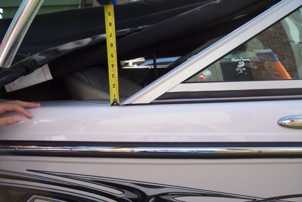

    I have a 2007 216 with a weird little issue related to my windshield. Where the windshield meets the boat, there is a small gap. Almost not noticible...but it's there on both sides of the boat. Here is the issue....
    When you are wiping down the boat, you can catch your finger in the gap and it's fairly sharp, so we've had some bandaid needs. Also, on the Starboard side, I use a boom a lot...so when I lean out, I tend to catch the armpit of my t-shirt and it ends up ripping.
    I just got the boat this past spring. And, I have been working with my dealer over the summer to try to come up with a solution. But, we haven't had any success. So, I thought I would send this request out to the very creative folks on this site to see if anyone might have some suggestions.
    I was thinking that soime type of rubber gasket (trimmed to fit) might work. But, I am not sure. Would probably need some type of glue to hold it, but it needs to look halfway decent.
    Thoughts?

              The windshield weather stripping is supposed to carry out underneath that edge and be trimmed off cleanly. You have the gap because the weatherstripping was cut off too short. JMO

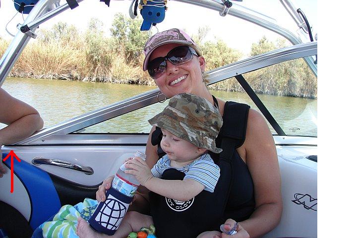

                  Agree. Here is the best picture I could find, but the weather-stripping goes all the way to the end of the trim. I have no issues with it.

                    i agree with Madhat, my trim looks like the pic from BP22

                      I took off my windsheild last winter (06/07) and had the frame powdercoated, had to re-assemble and reinstall back onto the hull. It's NOT easy! I would say from looking at your pics, that the angle of the windsheild header was not cut correctly, therefore not sitting flush with the hull. The gasket that CC uses between the windsheild frame and the hull is thin, probably only about 1/16" thick, and it compresses to almost flat when the windsheild is screwed onto the hull.
                      Trust me, make the dealer fix it. You've bought a new boat, it should not have been delivered that way. If you start messing with this, you might break the windshield glass, and that WILL be expensive!

                          • OHLNautique
                            • 140
                            • TN
                            I too agree with letting the dealer handle it. As a result of your post I have checked mine out and looked at an 09 210 at the dealer today. Both have the seal under the windshield going all the way to the end. I'd say it's obviously a manufacturing defect. Let them handle it.
