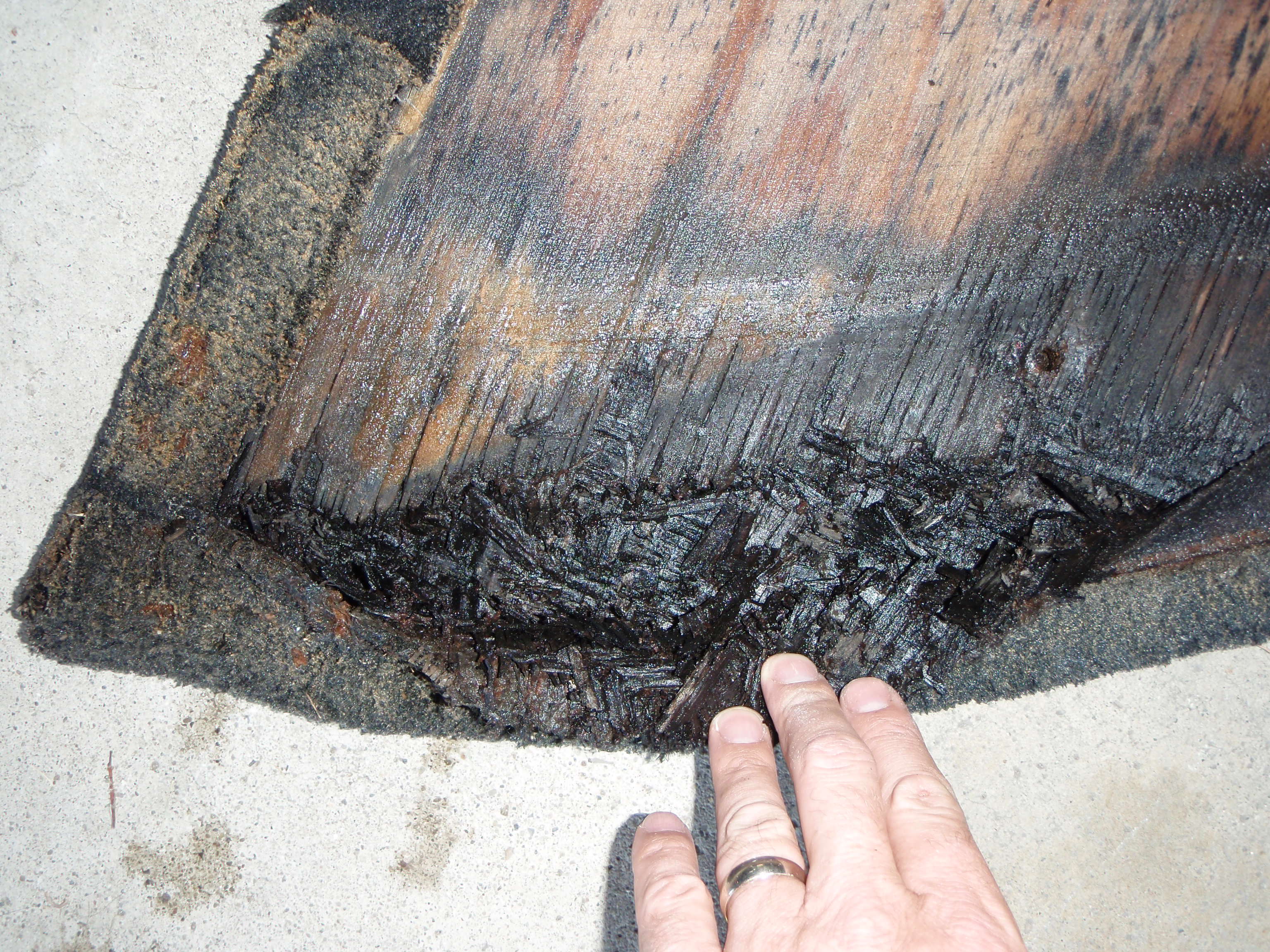

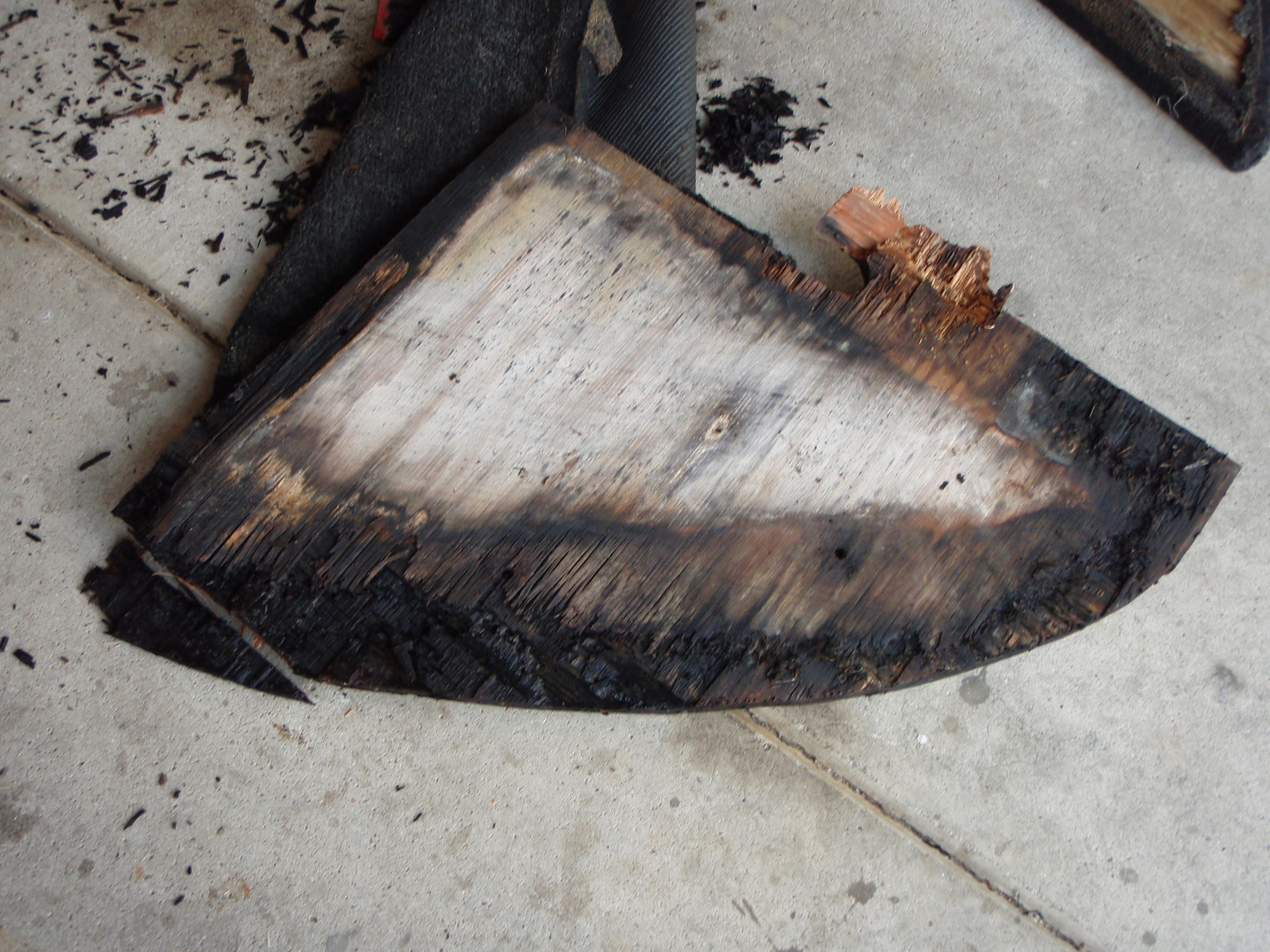

    I've finally gotten around to yanking the wood steps off my '01 RamLin and they were completely shot, literally falling apart. The carpet introduced rust everywhere it's contacted so I have quite a job on my hands to clean it up. I've already touched up the rust spots, but am now looking at what to replace the steps with. I've seen quite a few ideas including teak, star board, etc., but I'd like to keep the price down. Treated plywood w/out the carpet is looking like the best option, but I'm not sure what to coat it with. Lots of talk about rhino-lining, but when checking into that stuff I've read it gets tacky when wet, plus may not stick to wood, especially treated plywood. I think the treated plywood is really the way to go, but I'd like to cover it with something to give it a little better traction plus make it not quite so freakin' ugly. I'd like to get it to a black color, as well.
    Anyone have any experience along these lines or in a similar situation? In perusing many different boat forums it seems I may even be better of trying regular plywood and treating it with heavy duty paint of some sort. Without the carpet holding moisture in, it may hold up pretty well.

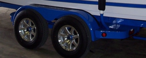

                              I have a new Ram-lin trailer with Checker-Plating. Love the look...but, I have already had a couple folks slip. I see some posts about using some non-slip stick on pads....what type are you using? I really need to address this over the winter.
                              When the slip occurs, it is someone that is getting out of the boat, they step down with one foot on the checker plating......then they drop on down to put their other foot on the ground, the foot on the checker plating slips forward and they drive their shin into the edge of the boat. Leaves a nice bruise.
