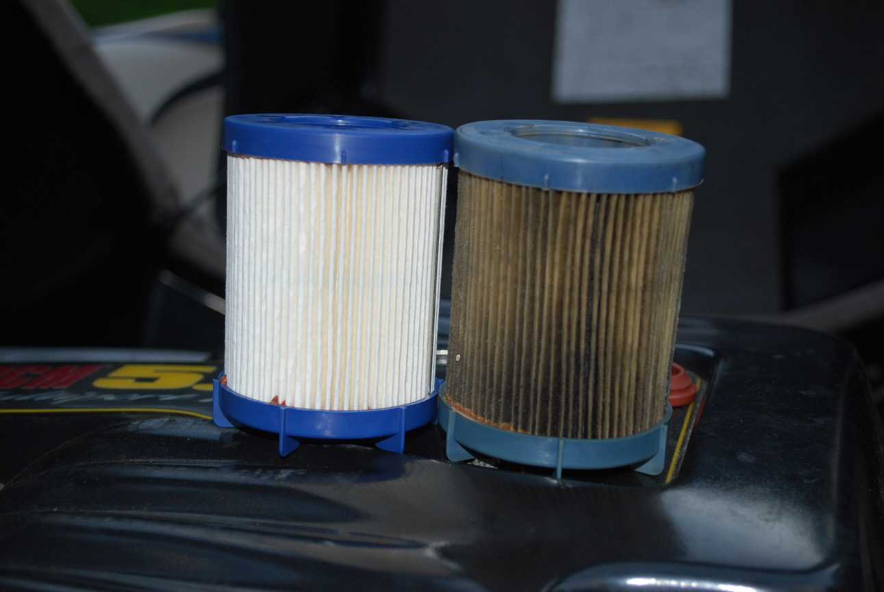

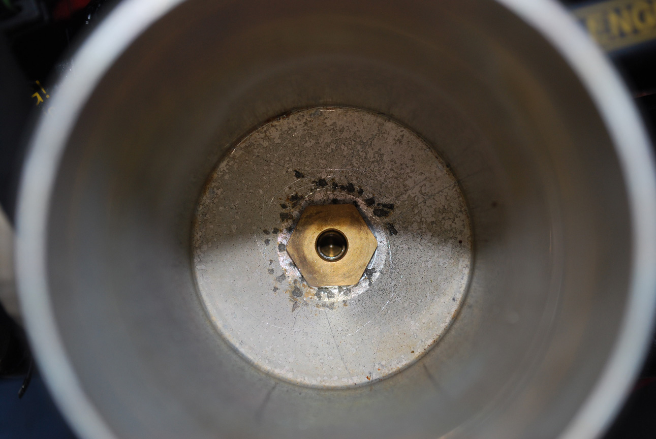

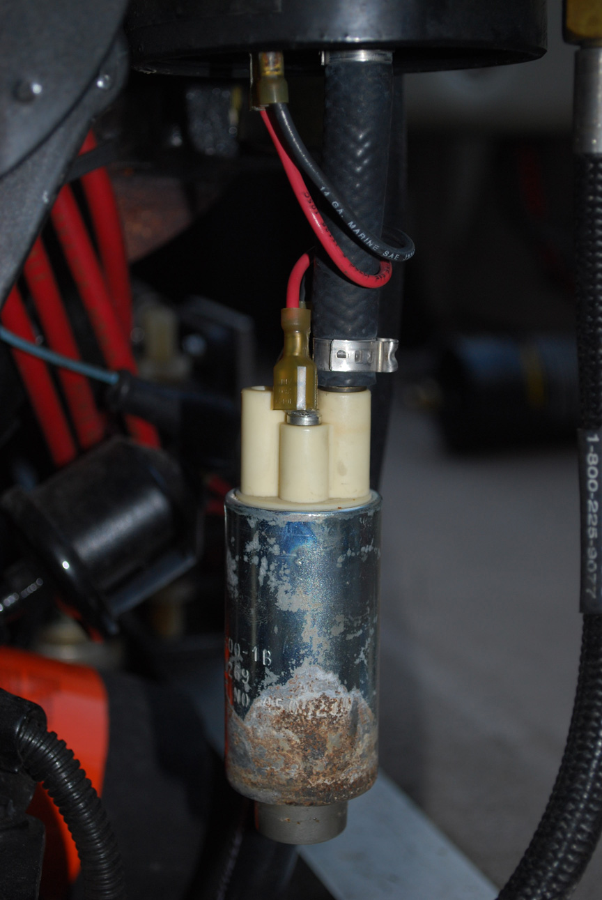

Have a 2001 Air Nautique, 250 hrs, with GT40 engine that will stall or not start. After a little while, engine will start again. Definitely seems like a lack of fuel issue. Some history, bought the boat second hand a couple months ago. Was serviced and supposedly changed fuel filter. also gave me a spare. When boat dies, I push down the schrader on the FCC and get a squirt of gas. Push down the schrader on fuel rail by distributor and I get a hiss of air then gas. Open 1/8 pipe fitting on bottom of FCC and get a small amouint of gas. Low pressure fuel pump runs when the engine is turned over. Boat ran fine first 20hrs, except for a few times when it seemed not to take the gas when you pushed the throttle down. Last 10 have been a real headache! All fuel lines look fine. My first guess would be fuel pump. Any help will be much appreciated! Boats back home and will be trailered til nap time.
