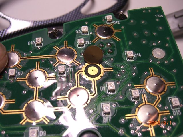

kepad disasemble
The start keypad still can use for some time , notice the '4' bad contact becomes worse recently, take it out and disasemble for inspection, found that is a PCB have IC on it , ,button side is clean looks not bad contact there,water oxidesing can be seen at the edge of parts side, means its not serviceable since this side are sealed with epoxy. some water goning from the sealed edge into inside of PCB and corrode the circuit,the photo shows a clean botton side. ' need more try to fix the '4' problem.
Richard, thanks for posting the pictures and for the report back that it works. Congratulations on a successful surgery. Hopefully the repair will last and you can avoid the cost of a new one. You might have given future holders of bad keypads hope for a more economical fix.
