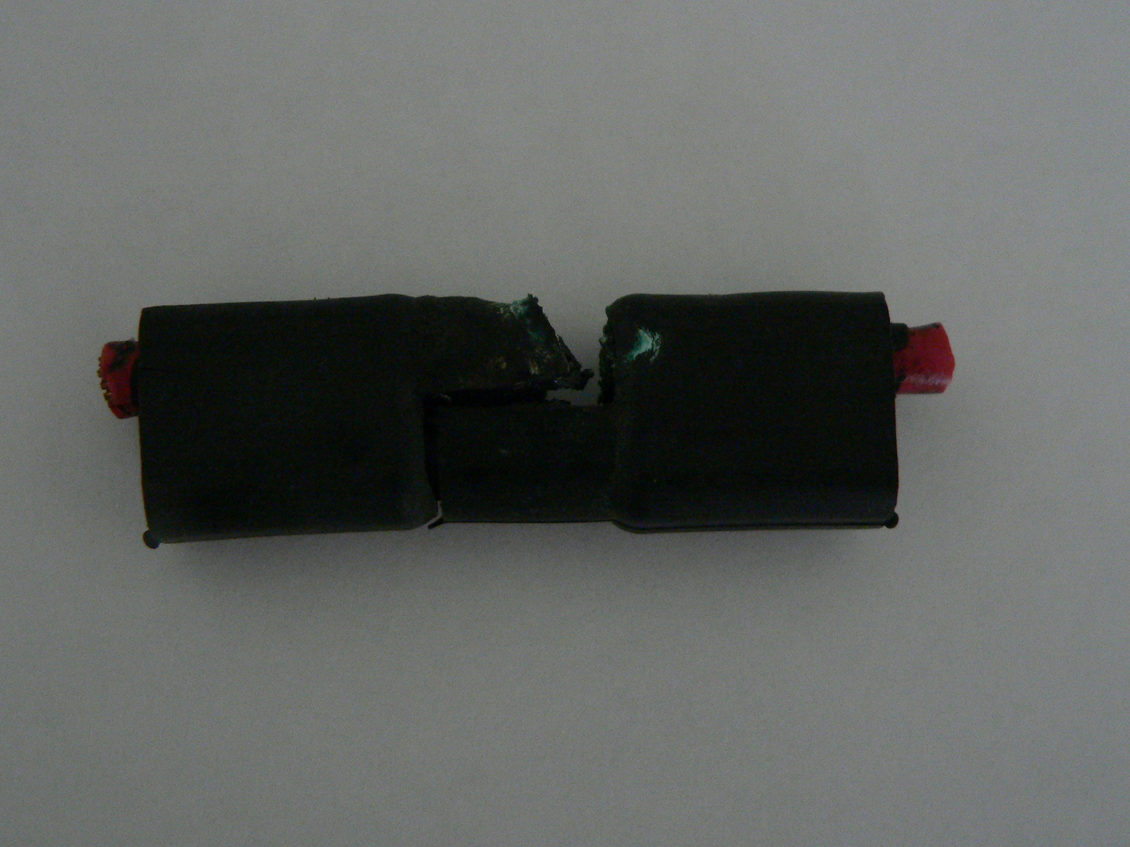

                    Received a call back from the Mechanic. Boat is ready to go. Seems as though there was a wire which feeds the electronic fuel pump (whcih was not bundled within the main wiriing harness that for some unknown reason was spliced with a push type splice connector. The connector failed due to corrosion, was removed, wire re-routed, tested and all appears to be AOK. Water test for later this afternoon.

                      Here is a picture of the culprit :shock:
