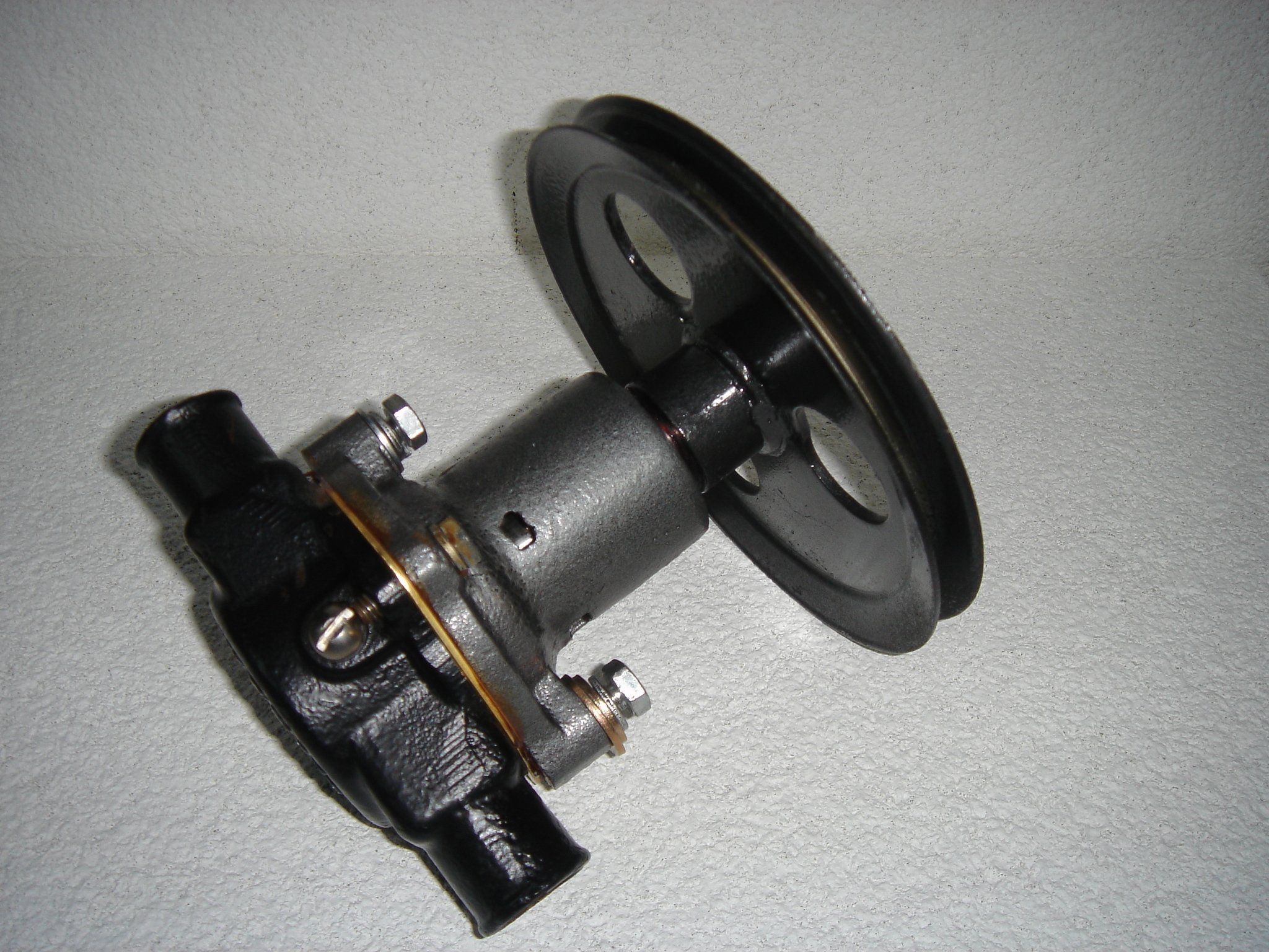

So, I finally got it done. Replaced everything internally, painted everything externally and slapped it back together. Let me tell you, this thing was a pain in the you know what!! Hopefully, all of my cooling problems will be behind me and I can have a good time on the boat this weekend.

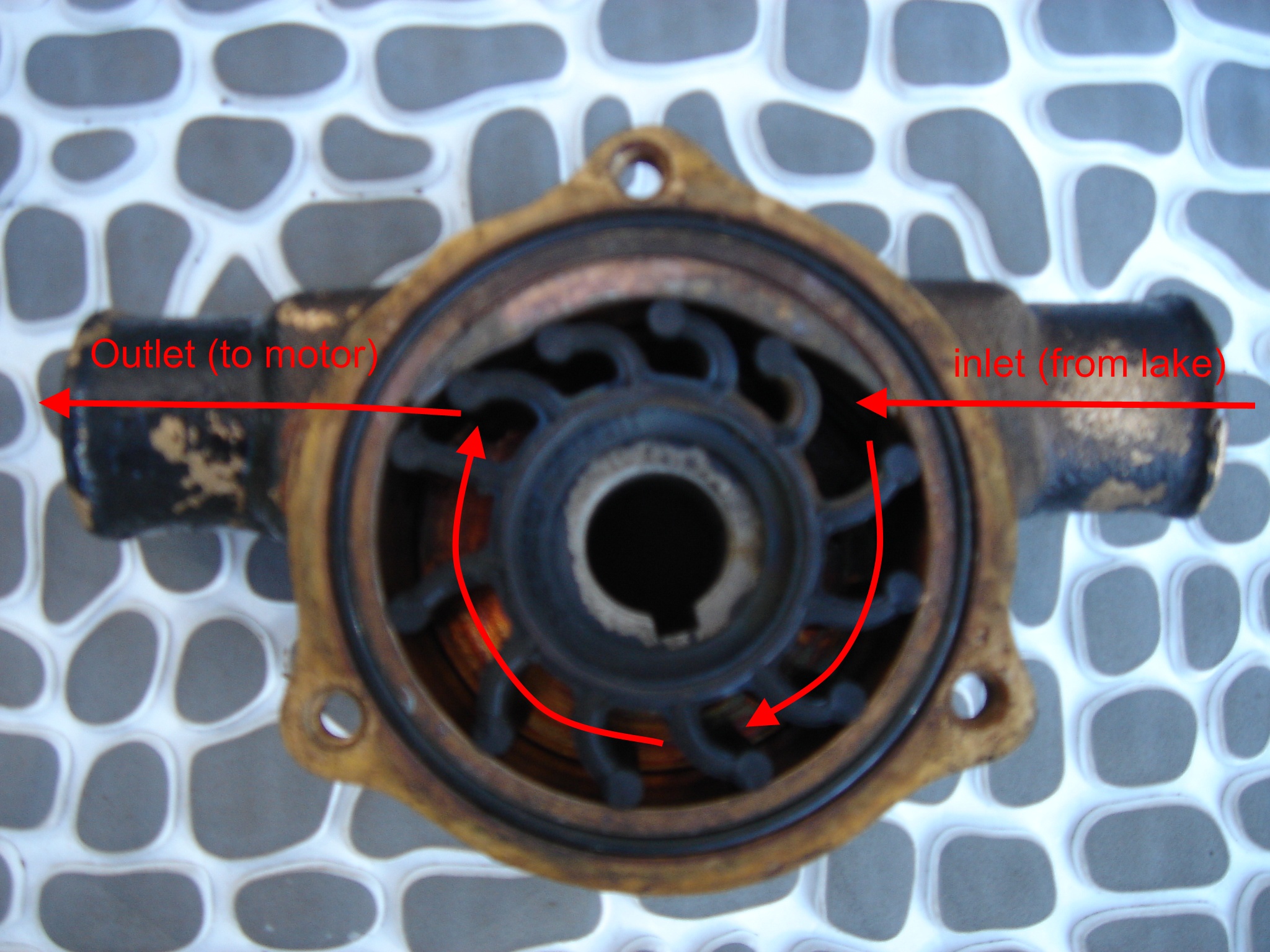

BTW, can someone confirm for me that the water travels the long way around the pump? Here is what the impeller looked like prior to the rebuild. Does that look right?Player\'s Edition SSN. Pimpin\' the rest....

Yes, the water travels the long way around the pump. Think about it, the water gets squished out as the impeller blades are crushed in by cam in the pump housing, on the outlet side, and sucked back in from the lake as the blades open up on the other side of the cam. The big space in between the impeller blades carries the water around the pump.
Correct Way?
From reading DanialC's post I beleve this is the correct way. In this picture it is going right to left.
Originally posted by Rock_ToySo, I finally got it done. Replaced everything internally, painted everything externally and slapped it back together. Let me tell you, this thing was a pain in the you know what!! Hopefully, all of my cooling problems will be behind me and I can have a good time on the boat this weekend.
