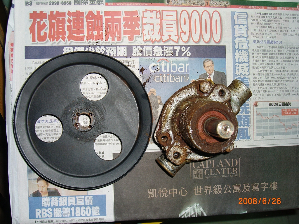

        raw pump pully remove
        it's a pain to remove the pully of the pump since the design is not for removable,I had remove 2 time since I change it with aliminium pully, I can't remove it with a puller,even the machine shop that make the alumi. pully for me, I drill 4 1/8" hole around the shaft ,and than have the chance to get the pully out by puller. carefully not shred the shaft but little bit touch to the shaft need. see pic. I suggest you take photo step by step for not confuse when assemble,one time I tried to rebuild the pump for leaking near the shaft,I change new one at final,I confused when assemble,also new pumpt give me peace of mine long time.

          RE: raw pump pully remove
          Sorry Richard I just had a laugh on your behalf. While I was reading your post I was thinking I am going to ask this guy if he is Asian as a joke because of your wording, but then I saw the newspaper in your picture and decided to keep it to my self. Or did I?? Sorry it was just funny to me.

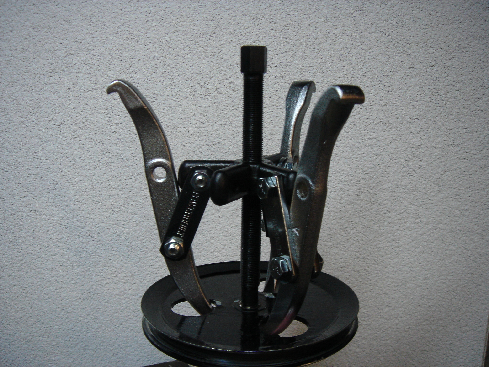

              RT, Is your pulley the same as Richard pictured? What typ of puller are you using? A 2, 3, or 4 arm and where are you grabbing the pulley? If you are grabbing it by the OD, you will get a lot of flex in the web of the pulley and besides not dong any pulling you may even distort it. I suggest a 3 arm through the 3 holes so you grab it close to the center hub. Yes, heat will help.

                Yep, same pump and pulley. Here are pictures of the pulley puller on it. As you can see in the close up, it has bent the insides of the holes a little bit.....although I am sure that i will be able to hammer that back in. Being so close to the middle, it shouldn't really effect the operation of the pump or throw off the bearings. Guess I'll go an heat it up a little and see what happens.

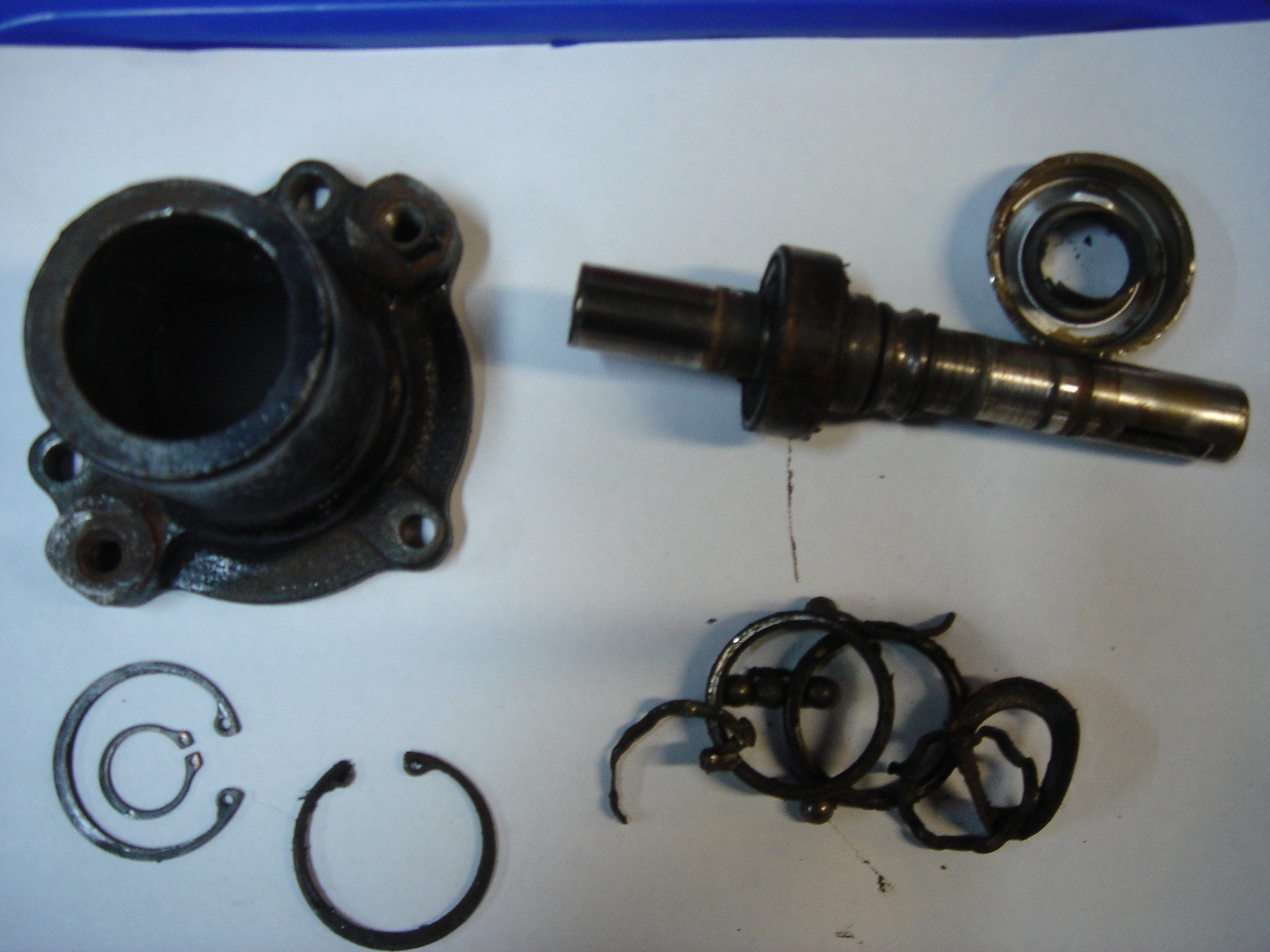

                  OK, got the pulley off. That was NOT easy and I never want to do it again.....or think about getting it back on :mrgreen:
                  Here's the mess that came out of it. Look bad enough? I managed to get what was left of the bearings off the shaft and cleaned everything up.....but now I can't get the new bearings on. I just popped the shaft in the freezer and am going to warm up the bearings a little to see if that helps. If that doesn't help, I am assuming that I am off to the machine shop to get them pressed on, right? I'll post pictures of the progress along the way for those that ever think about doing this.

                    Remind me, why are you rebuilding the pump? That bearing looks like it had a lot of life left in it.

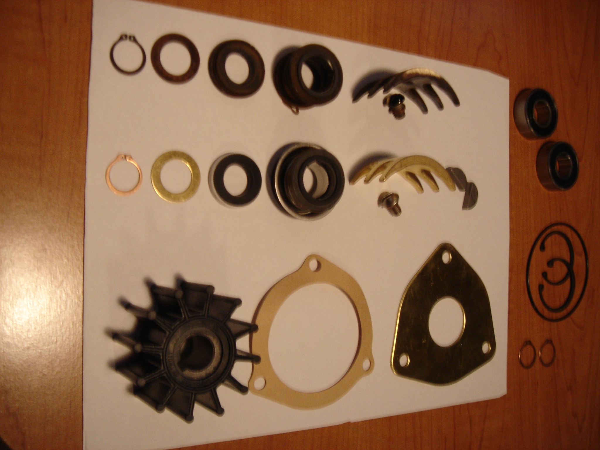

                    Where did you get the rebuild kit? Did it include everything pictured, including the impeller?

                      I bought the kit at go2marine.com. Cost me about $100. It included everything that you need, which is what you see.
                      Now I need to get it back together. All the parts that I will be recycling have been cleaned and painted and waiting to come together. Pump should look and feel better than new in a day or two. Stay tuned for pics.

                              RT, I think you need to go to the machine shop and use the press to get the bearings on the shaft. You can try chilling the shaft in dry ice and heating the bearing but om small bearings sometimes the method doesn't work. A press would have been a good choice to remove the pulley too. When you get the pump back on the engine, get a straight edge and check the pump pulley to make sure it's not distorted from the puller.
