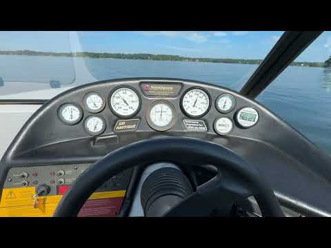

The boat was in pretty good condition when it arrived, but we started out by wiring in a new dedicated ground wire for the dash that ran straight to the engine block. This eliminated ground issues that plague this era of Nautique. We also installed a ground bus, a new GPS speedometer, and a new ignition switch.

Here's the test run video:
