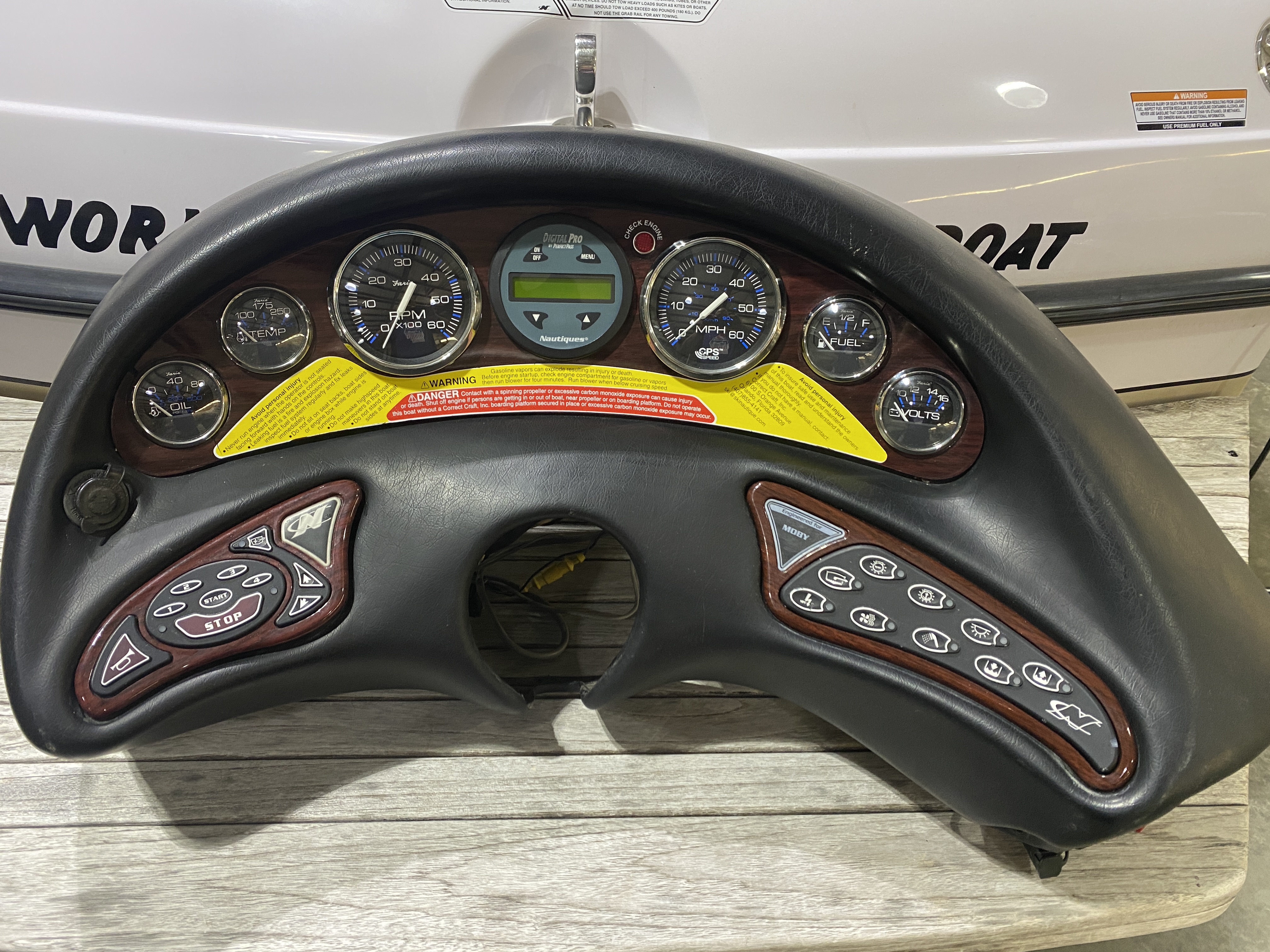

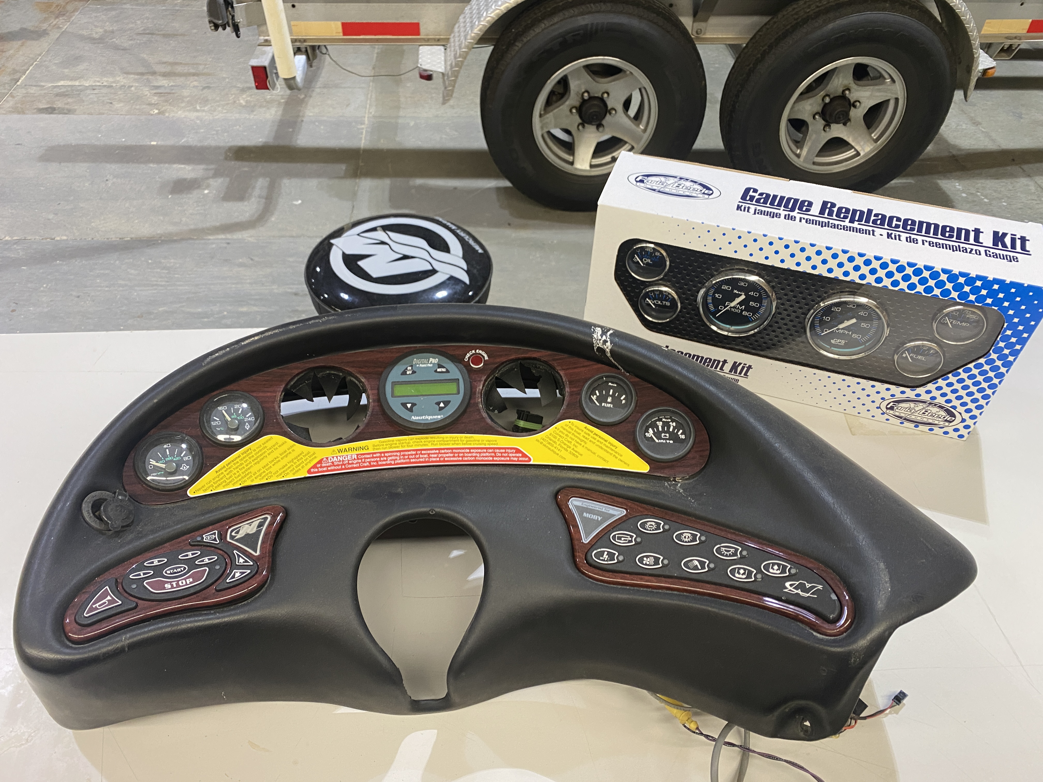

Took care of the dash on this boat last night.
The old digital gauges had failed (big shocker).
Instead of replacing them with the Nautique kit, I decided to order the Faria Chesapeake gauges, including the GPS speedometer. This kit is about HALF the price of the Nautique replacement speedometer and tach, and instead of using the PerfectPass paddlewheel for speed input, it uses GPS. On top of that, it replaces ALL of the gauges, not just the speedometer and tachometer. That way ALL of the gauges match.
My dash had a mix-and-match set of gauges -- the original digital speedometer and tachometer, original oil pressure and temperature gauges (which never did match the original speedometer and tachometer), and aftermarket Faria fuel gauge and voltmeter that didn't match anything else.
Here are the before and after shots:
BEFORE:
AFTER:
That's a first
....not often you hear Jeff bitching about Nautique support. But I agree...the whole Faria gauge replacement thing is a fiasco.
Remind me - does this boat have a gateway box or not? Thinking no...and that's what lets you use this kit?
Edit: BTW, that big yellow warning sticker needs to go. I get that it's "required" but it's really horrible.2004 206 Air Nautique Limited - Black with Vapor Blue (family style)

When there is a better, less-expensive, and easier-to-install solution available than what Nautique comes up with, I am all for it! Especially when it makes all of the gauges match.
The only thing about this system is that it requires you to remove all of the spade connectors that the factory used at the gauge connections and replace them with ring terminals. That's not necessarily a bad thing though, since ring terminals are much better. It is time-consuming though.Please do not PM me directly asking for advice on how to repair your boat. While I would love to help everyone, I simply do not have time to respond to all of the inquiries. Please post your questions on the forum, so that all of our members have a chance to answer.

Looks super nice, those new gauges pop for sure!
