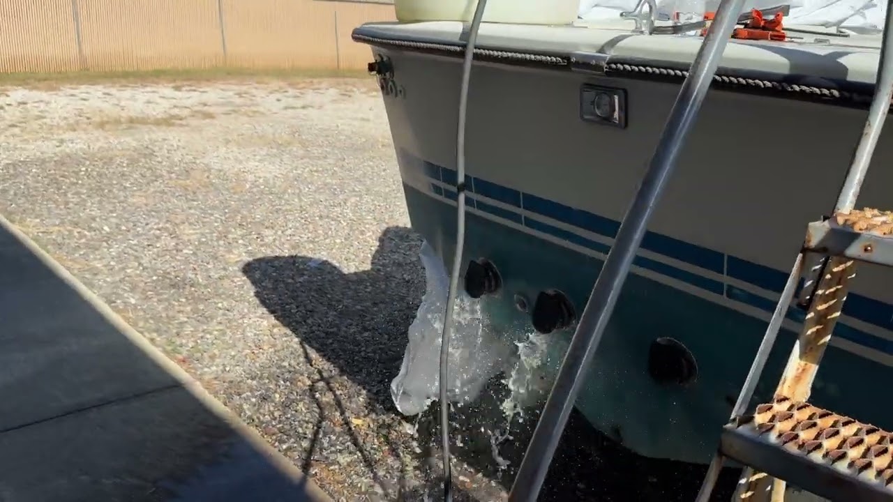

Got both engines started...
But, the decision was made to pull the boat back out. One engine was whining badly. We think the distributor in that engine may have a failing bushing. The other distributor wasn't hooked up to vacuum for the advance, since that carb didn't have a vacuum port. I am going to buy two new distributors with mechanical advance so that they can match and both work the same. We also found that they had hooked the throttle cables up backwards (pushing forward REDUCES throttle).
So, a little more work to do, but at least they both run!
