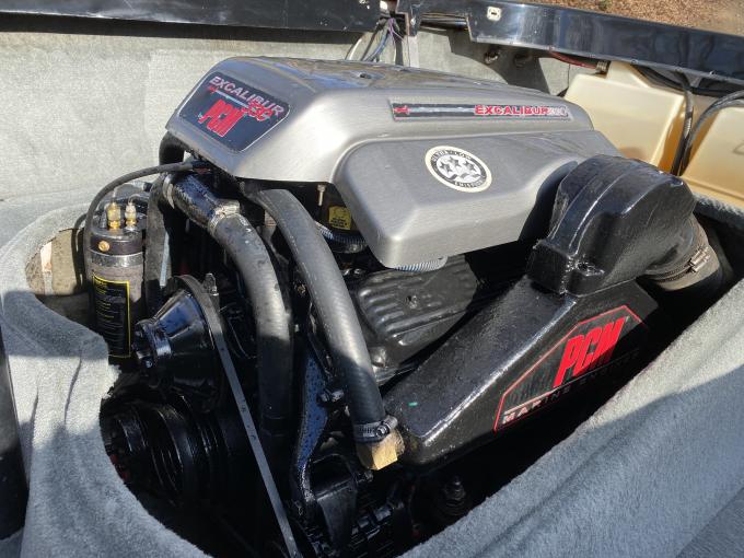

I went down to PCM and picked it up today, and they went ahead and did a full rebuild on the engine. It was pretty rusty inside, and they said that was the only thing to do. The block was machined, and lots of parts inside were replaced. It got a new FCC and new manifolds as well.

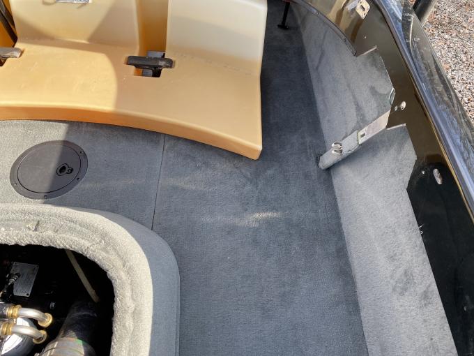

Spending some time on the carpet today.

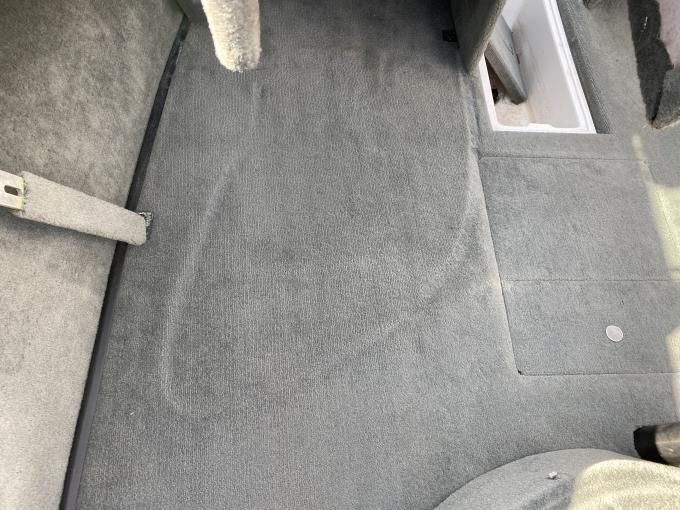

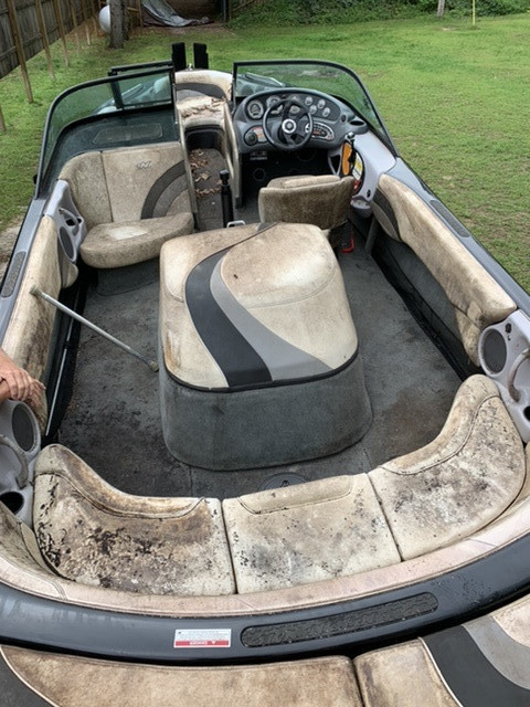

Let's remember where we started:

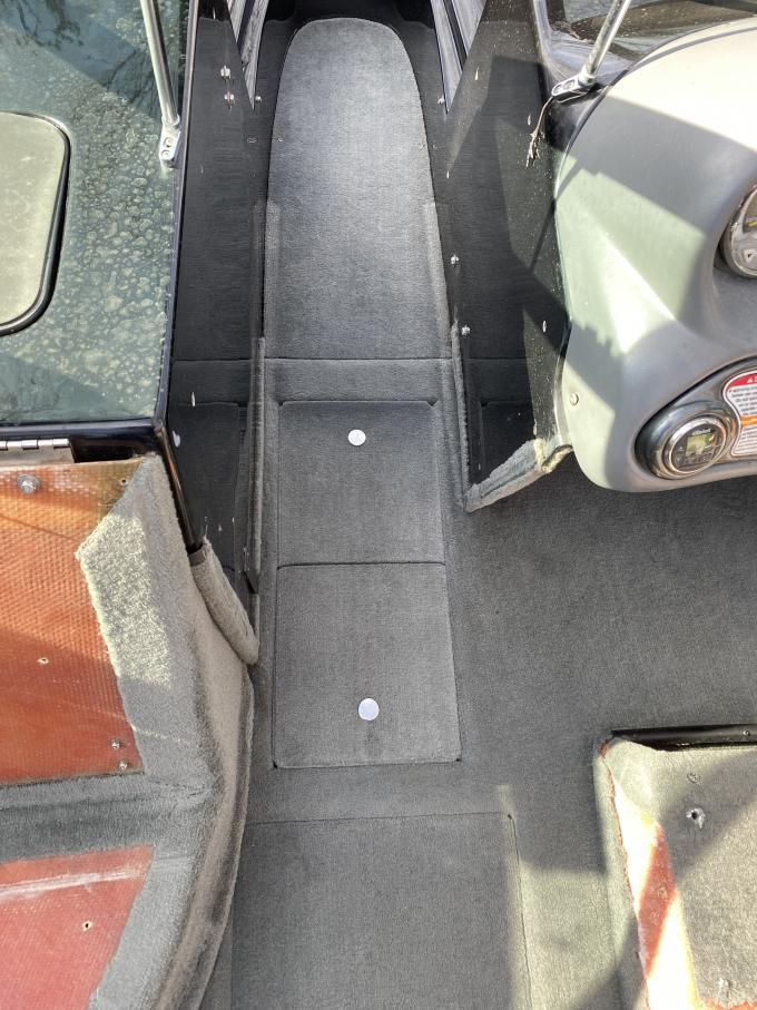

And here's the carpet today after spending some time using spray nine marine and an old push broom as a brush, and a pressure washer.

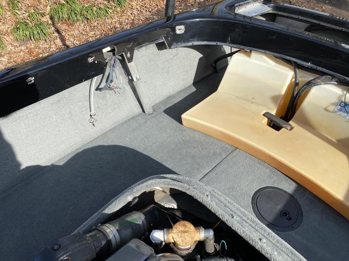

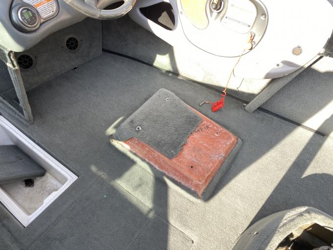

This last picture was before I scrubbed and sprayed the side carpet behind the throttle handle.
You can see the difference on the section that has been completed here.

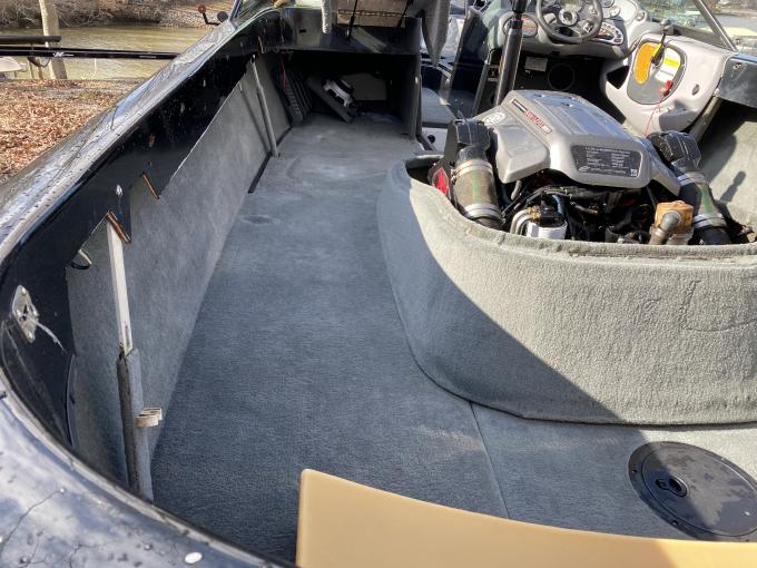

Oh, and here's a shot of the freshly-rebuilt engine. Doesn't look much different than before, but now it runs!

I just wet everything down, spray on some Spray Nine Marine (just a small amount is all you need), and scrub with a stiff brush. Then I pressure wash it with a medium tip. Be careful not to hit the speaker covers because it'll tear them. The carpet handles the pressure washer just fine. Flush and flush and flush until there is no more sign of suds from the Spray Nine Marine. Using too much Spray Nine Marine will lead to extended flushing!
I just let it dry in the sun for a day or so, and then it goes in the garage with a dehumidifier and fan on it.Please do not PM me directly asking for advice on how to repair your boat. While I would love to help everyone, I simply do not have time to respond to all of the inquiries. Please post your questions on the forum, so that all of our members have a chance to answer.

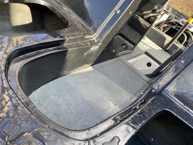

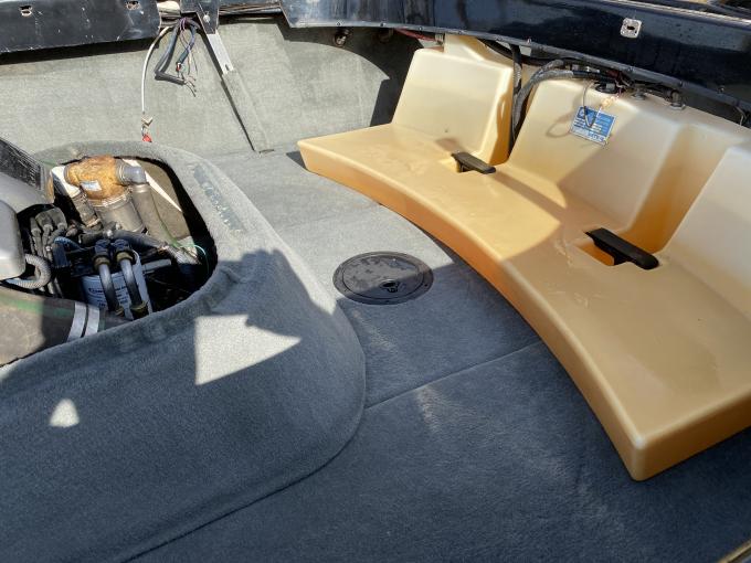

Carpet is pretty dry at this point. I think it turned out pretty good!
I went ahead and squeezed it back into the garage and I have the dehumidifier running to pull out the last bit of water in the carpet.
