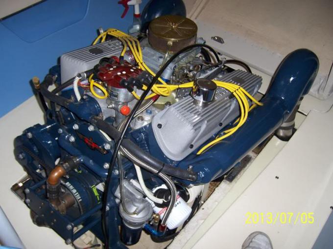

            If you run in salt the manifolds last about 7 years. Freshwater is a different story. I bought my Holman Moody powered Mustang 32 years ago for 150.00. Owners mechanic said the original manifolds would be bad, but make sure you look them over carefully owner didn't want to go through the hassle of finding something and installing so he passed it on. They are going on 52 years now and if they leaked tomorrow I'd have them repaired- it's a big part of the HM look. Since you can still buy new ones it just might be a smart move but make sure you check them out carefully before installation. I recently bought a set that had a manufacturing defect that should have been caught before shipment, set me back 2-3 weeks to straighten out.
