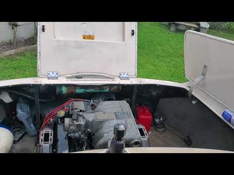

      shes squishing shes bangin and shes blowing but she didnt start shes turning a little slow. i think the battery voltage is a little low as i only have 1 battery hooked up and ive been cranking it a couple times already and no charger. boat is in storage so its a pain to work on it i always have to take all my tools with me when i go and forgot my multimeter. im taking another battery this week well see what happens but im pretty confident!!!

                  SHES ALIVE!!!!!!!! pro tip. Never trust timing marks on the harmonic balancer. Always manualy find tdc for timing adjustment!!

                    If your timing marks are off, you might want to replace the balancer. Not sure if PCM uses Ford parts for this (guessing they do) but the stock Ford balancers are notorious for slipping the outer balancer ring.
                    It's one of the first mods the Mustang guys do to 5.0s and not because it gives more power.

                      PCM does use ford parts. This balancer fits just fine: https://www.summitracing.com/parts/sum-163289/make/ford

                          better video with manifold installed time to focus on the cockput
